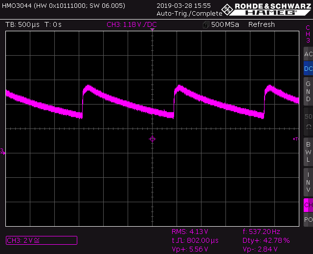

This event seems to happen when the embedded system is powered on and when I hold the PCB within my hands. Digging into the problem I've discovered that I'm causing some kind of interference of the LM26001 IC what causes a oscillation on the output of the regulator. When my fingers touch the PCB or components that belong to the LM26001 the output starts to oscillate. This oscillating produces a high enough voltage that kills my microcontroller.
The Buck converter is configured to produces a 3.3V output and powers the microcontroller, CAN transciever logic section and Flash memory. The input voltage is 24V, during testing a linear lab power supply is used to power the device.
The following screenshot shows the oscillating behavior of the buck converter when i'm touching the PCB/components around the LM26001 with my fingers. It can be seen that a too high voltage is generated which causes my IC's to fail.

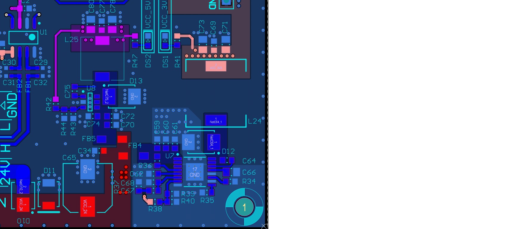

The following image shows the PCB layout section of the LM26001. The components that are visible are placed on the bottom layer (L6) of the PCB. Layer 5 is a solid GND plane which covers the entire PCB.
below: PCB Layer 6
Below : Layer 5 thru 1
My question is if there is anything i could to in order to improve the immunity of the LM26001 IC in order to make it more resilient against accidental touches of fingers while operating.

  • Arjan ,
    The design is marginal stable . Here are the changes you will ned to do in order to a stable closed loop for this design :
    1. Add 2 * 22uF 10V cap at the output .
    2. Reduce the Rcomp to 5k from 10K ie R37 .
    Further here is the feedback on the design :
    1. Connect a bulk capacitor at the input parallel to C59 . Use 22uF or higher bulk capacitor .
    2. Why is Bias connected to GND ?
    --_Ambreesh
