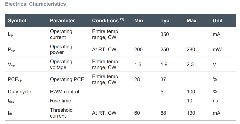

Is the LM36011 a good choice to use with IR LED?
1)
We have a 3.5V to 4.2 input voltage.
How is the V_LED voltage regulated ( in the DS in tables i see that Vled is 3.4V)? or do we only have to set the desired current eg 350mA?
2) what is the default mode of the led driver is it disabled?,to enable the output current/voltage then we have to set the bit0,1 (0x01) through I2C  eg. 11 (flash) and bit 3 to 1 (edge triggered) and then we need to pull the strobe signal high?

  • Hi Sean,
    is the LM36011 linear driver?
    What is the right way to calculate the dissipation on the driver if a input voltage is 3.7V and the Vled is 1.9V @ 350mA?
    In this case what is the value of input current?
    if we want to lower the dissipation is a led driver in buck mode better choice?
    Br,
    D.
  • Hi D,
    Yes, your understand is right.you can think LM36011 as an linear driver. when Vin=3.7V and Vout=1.9V, the votage drop of 3.7V-1.9V will drop on the current sink. The power cnsumption on current sink is (3.7V-1.9V)*350mA。
