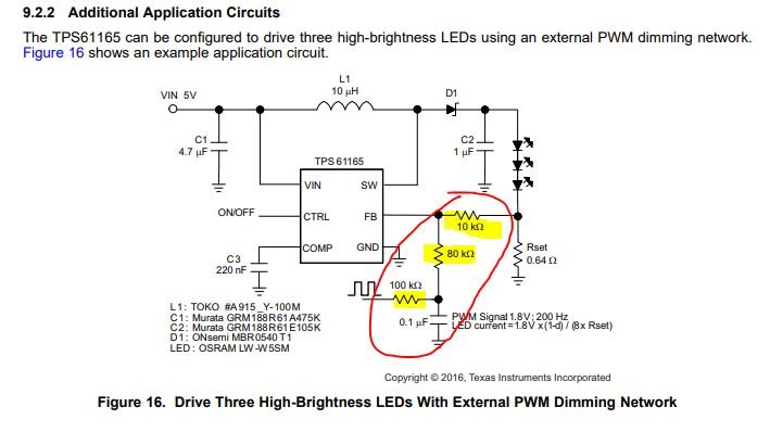

Hi Expert,
I would like to know how to calculate or get resistor value of external PWM dimming network, datasheet has no to show the detail. could you help to know that?
thank you,
Mark
