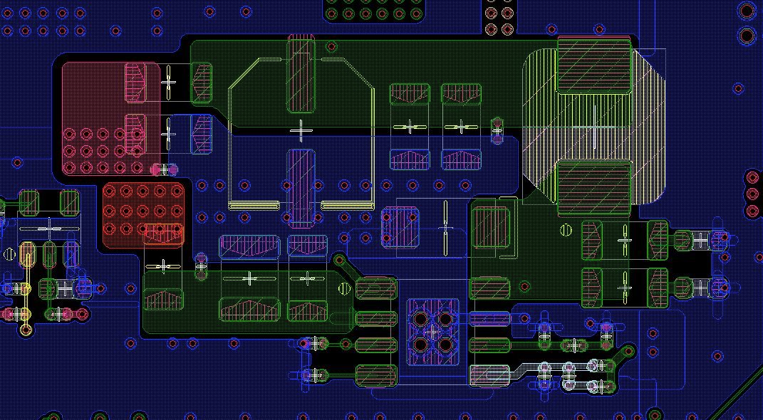

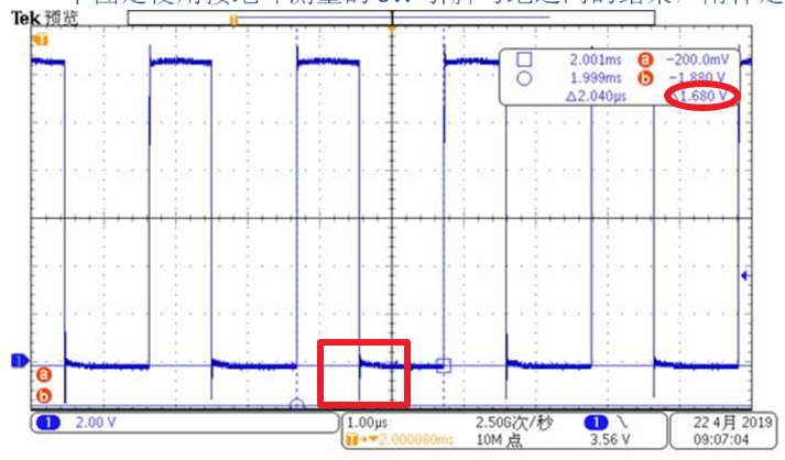

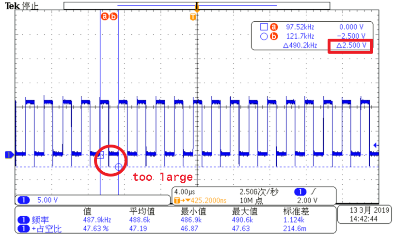

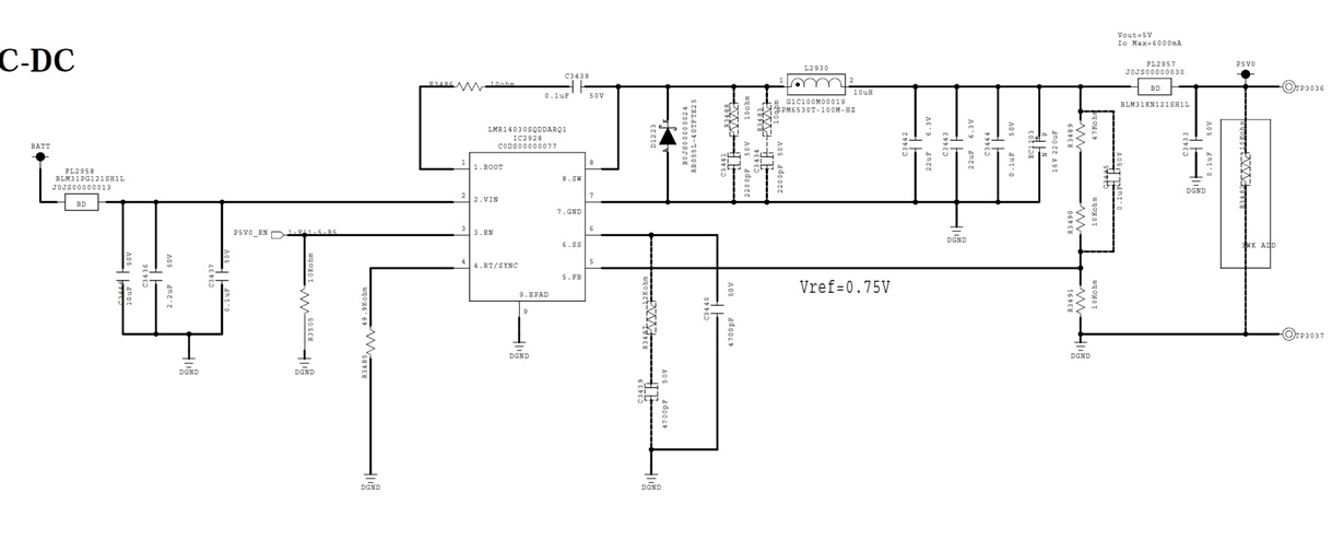

My customer is using the LMR14030-Q1 in several projects, now they encountered a problem when testing as below, the overshoot of the SW waveform(marked by red circle) is too large(2.5V), their schematic is the second picture. Could you please help give me the reason why the overshoot is so large?
