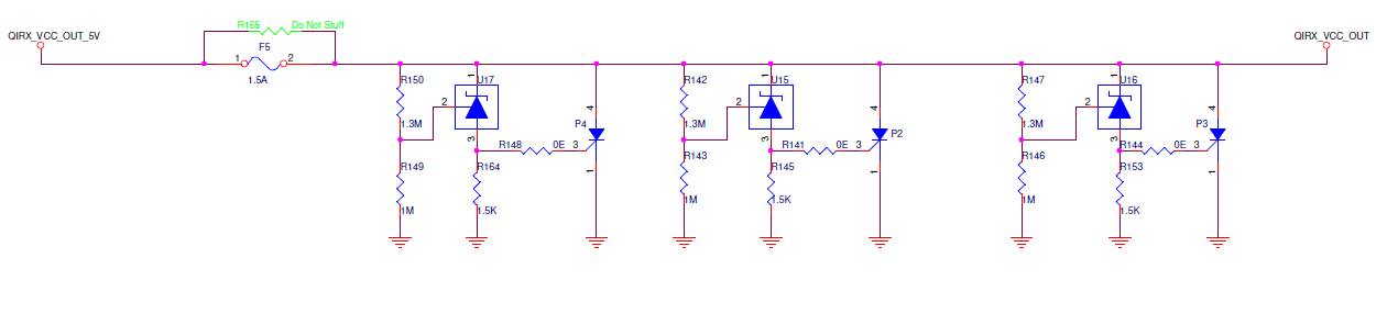

Hi TI team,
We're using LM431 in a Crowbar OVP circuit. We have been facing something strange in this use case of LM431; it is that initially the crowbar was triggering way above the designated threshold and consequently we made changes in the resistor divider circuit that defines the threshold for LM431, At this point of time the crowbar seems to be working fine but whenever we try to measure the reference voltage being received by LM431 using multimeter it triggers the crowbar, even though the supply is 5V.
Below is the circuit: Version 1

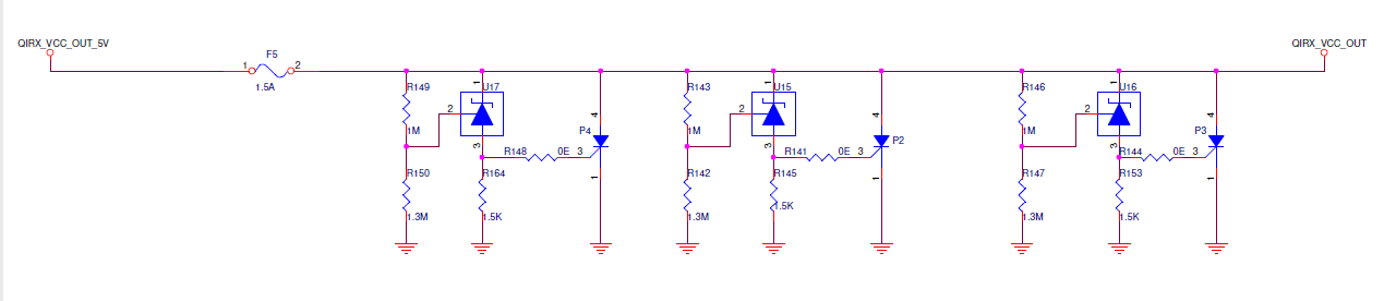

Version 2: Modified resistor divider.
With version 1, the OVP was triggering at around 7V and with version 2 it is triggering at 5.7V.
But as stated above the OVP triggers whenever we try to measure the reference voltage of LM431.
Could you give us some insight on the cause of this?

    I understand your point that this triggering could be the reason of loading effect of the multimeter but irrespective of the input impedance of the multimeter I should observe only incorrect reference voltage reading. Shouldn't that actually happen? If the multimeter has higher input impedance than 1.3M( used in resistor divider) I should observe a more accurate reference voltage and in case the multimeter has lower input impedance (if we take typical 1Mohm ) the loading should only decrease the net impedance seen by LM431 and hence lower voltage reading on multimeter.
    Another catch to this triggering phenomenon is that I do not observe this issue if I measure it on oscilloscope that uses probes of 1Mohm input resistance.

    2. As mentioned that in version 1 the input voltage that triggers the crowbar is 7V and in version 2 the input voltage that triggers the crowbar is 5.7V. I am measuring only input and output in such case nothing else.i.e QIRX_VCC_OUT_5V and QIRX_VCC_OUT.
