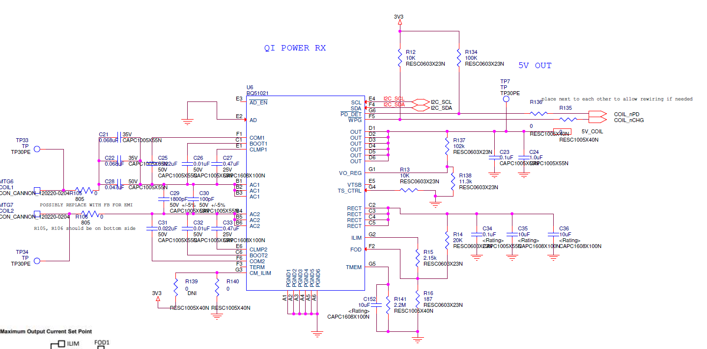

BQ51021: Migration from BQ51013B to BQ51021
Part Number: BQ51021
Other Parts Discussed in Thread: BQ51013B
I am migrating a design from BQ51013B to BQ51021 because I want to enable I2C and custom packets.  I am testing now and I get 5V and then after a couple seconds the circuit shuts off.  Reading through the data sheet I think it is because I have a 10k resistor pull down on TS/CTRL which makes the receiver think I am in over temperature.  You can see this is just a copy from the previous BQ51013B design.  We don't have support for a temperature sensor in this system so can the TS/CTRL pin just be left floating?  If not should I have a voltage divider from vtsb to ts/ctrl to gnd that keeps ts/ctrl at ~1V so it doesn't trip EPT or over temperature?
