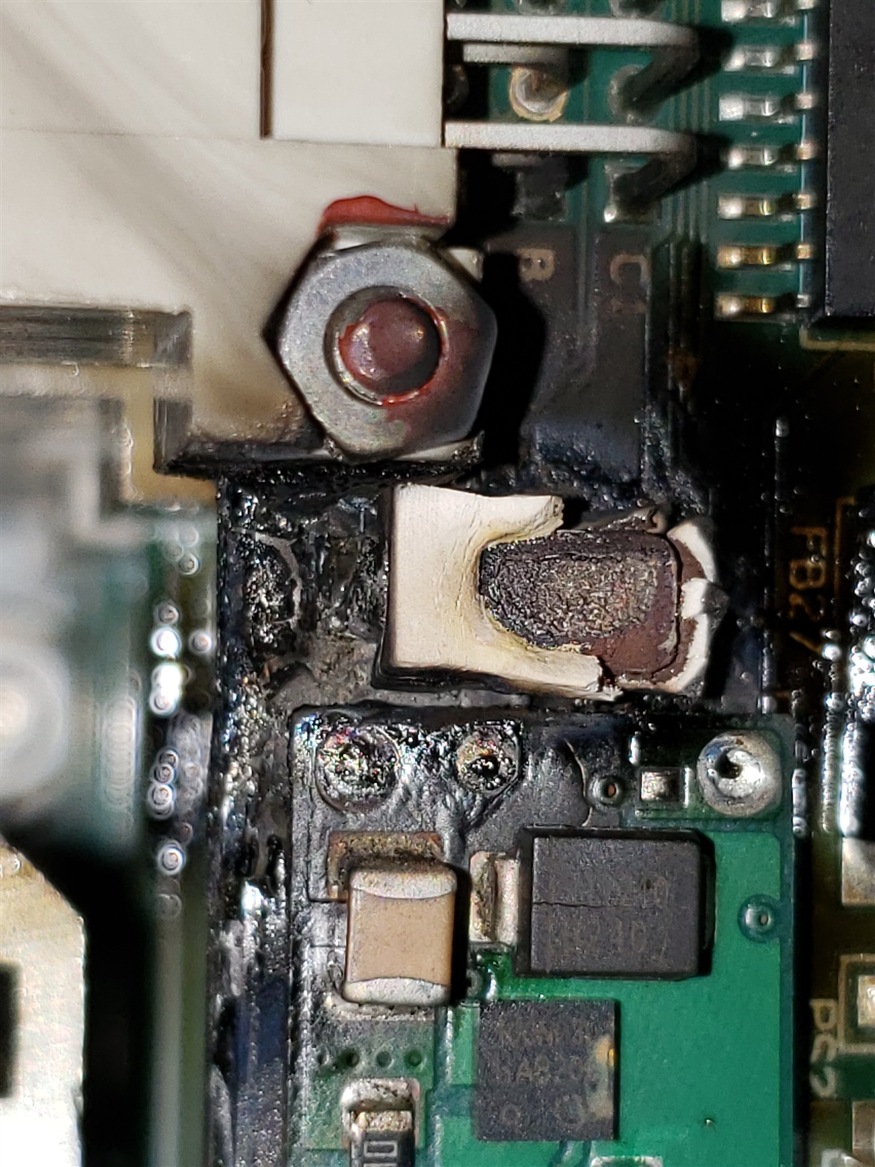

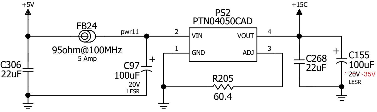

We are using the PTN04050CAD for a +15V source and have had a catastrophic failure.  The part overheated and or the output Capacitor "C155" on our board failed.  Can you provide the schematics of this module?  Is there a failure mode where the output can exceed the set  voltage?  The board was functional and in operation since 2014 at a military facility.
