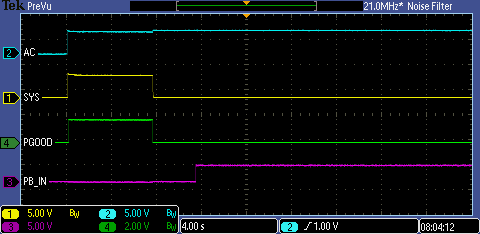

  • Hi Brian,
    Thanks for replying.  I have tried your suggestion but unfortunately this has not made any difference on my application.
    My problem specifically only happens when the power button is held low when power is applied.
    This scope image  depicts my problem nicely.  PB_IN is held low while AC is applied.  The SYS voltage goes high and the power on sequence is initiated correctly.  After 7.5 seconds the device resets and SYS goes low again.  PB_IN is released after 11.5 seconds yet SYS stays low indefinately until PB_IN is pressed again.
    Thanks again for your help.
  • Please re-take the scope shot and zoom in on the time between SYS going low and PB_IN going high.
    Instead of measuring PGOOD, please measure BAT pin.
    The four channels probed will be AC, SYS, BAT, and PB_IN.
    What you would be looking for is anything that occurs 1 second after SYS goes low. If you don't see anything on BAT, then measure nRESET.
    Holding nRESET will keep the PMIC in reset until nRESET is released + 1 second.
