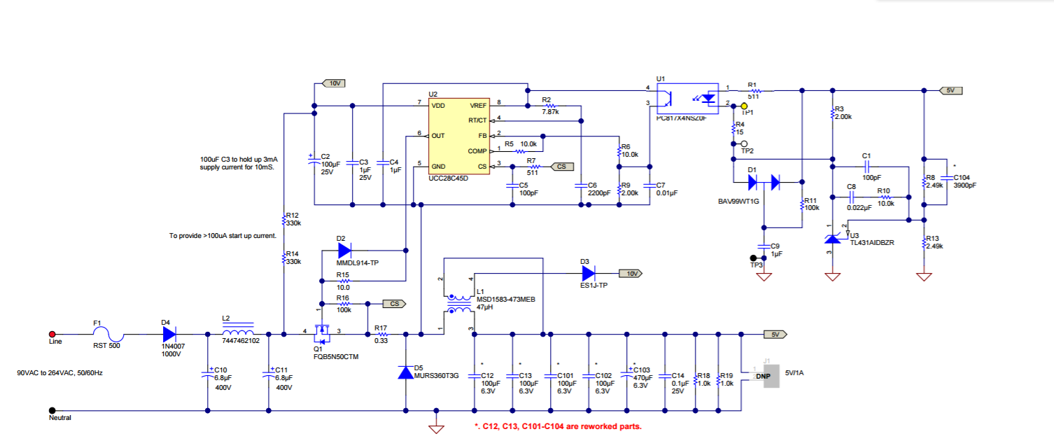

Dear TI EE:
                  I want to use UCC28C45D for Fly-Buck Converter.
                  I want to take'TI PMP10834.1 SCH' as reference.
                 The SCH from PMP10834.1 as below picture.
                 I want to refer this SCH to meet my design:
                  Vin(MIN):600VDC
                  Vin(MAX):800VDC
                  Vout(NORMAL):220VDC
                  Iout(MAX)=1A
                  Pout=220W
                  Fsw:100KHZ
Please help me the design or find the Coupled power Inductors to meet my design.
