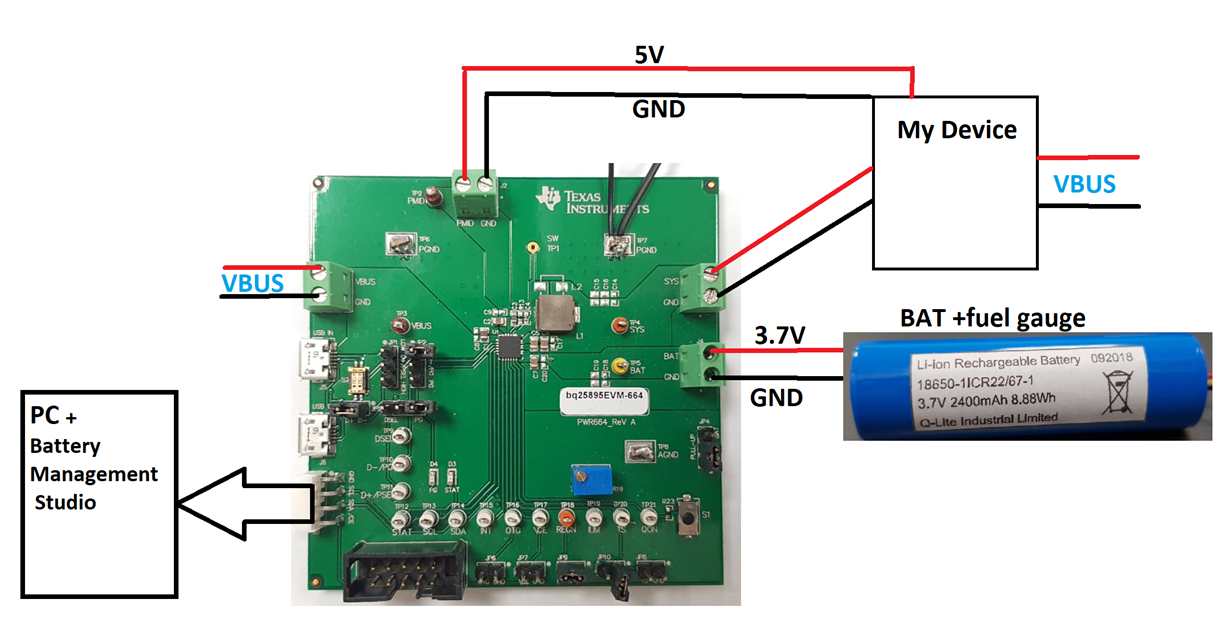

Hi all,
:I bought the EVK BQ(), and trying to integrate it with my device. Unfortunately there is some issues as ill describe below
  1. Accepted scenario: as long as the device connected to external Power Supply the battery is charging and the device is powered by PS. At the moment the PS is disconnected, the charger switches to BAT mode
  2. True scenario: As long as the device connected to external Power Supply the battery is charging .At the moment the PS is disconnected, the device starting to restart over and over.
  3. I tried to connect the battery directly to the device and it worked well
Is this problem is known? Is there a way to overcome this?
