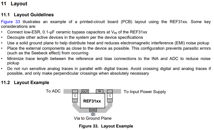

  • Cris,
    Is it possible for you to supply more of the schematic? I want to eliminate the possibility of this being an application circuit issue. In addition, I want to make sure that the layout guidelines were mostly followed to eliminate error where it could occur. These are the guidelines below:
    In addition, if you have any more data on the phenomenon you are noticing where the output voltage seems to be tied to Vdd, please let me know. This could be device failure, but it seems highly unlikely that 4 of the devices provided to you failed.
    Abhinav
