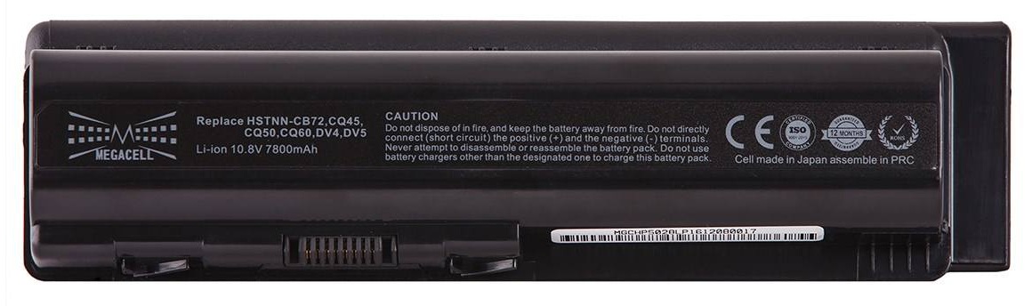

    it is a 9 cells Megacell battery suitable for HP Dv4 laptop. i use ManufacturerName() command and read "SDI".
    when i use ChargingVotage() command, i read 12.6V constantly and when i read the charging current, the battery send 3.5A constantly.
    Best Regards, Ras

    the battery is not original. bellow is a photo of it:
    Best Regards, Ras

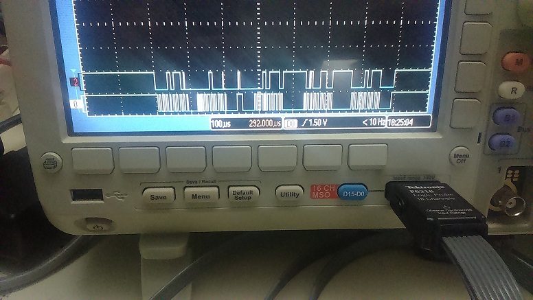

    please consider a photo of the clock and data lines on my logic scope showing a command from the host to the battery:
    i temporarily put aside smart charging. i charge the battery using a constant-voltage supply( 12.6V ) currently.
    i will add BQ24725A to the system in the next phase.
    Best Regards, Ras
