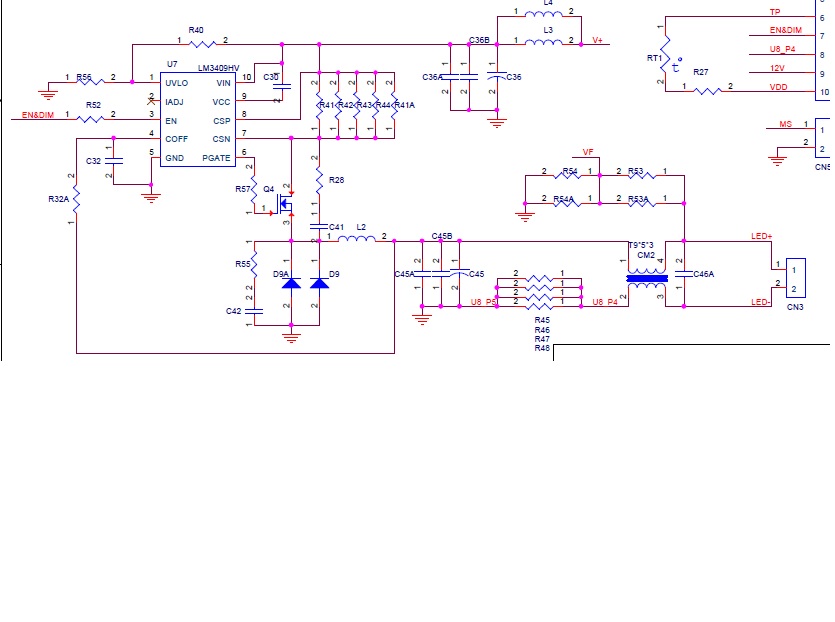

Hi Sir,
      We used LM3429HV and found if different number of LED series, the current is different in same dimming ratio as attached file,would you please help to check whether the schematic is problem or give us a direction.Thanks you!
 dimming curve.xlsx
    PWM dimming, via the PWM pin, requires the inductor current to rise and fall. If Vled changes the rise and fall times will change. To get more accurate dimming you would have to go to Shunt FET dimming. The on and off times for 20 KHz dimming will be affected by PWM dimming via the LM3409 PWM pin, the LED current set-point, Vin, Vled and the inductor value. It will work, it just won't be very accurate. Inductor current slew is V = L * (di/dt) where V applied (during Ton), is Vin - Vled and V off is Vled.
    Try PWM dimming at 200 Hz and see the difference.
