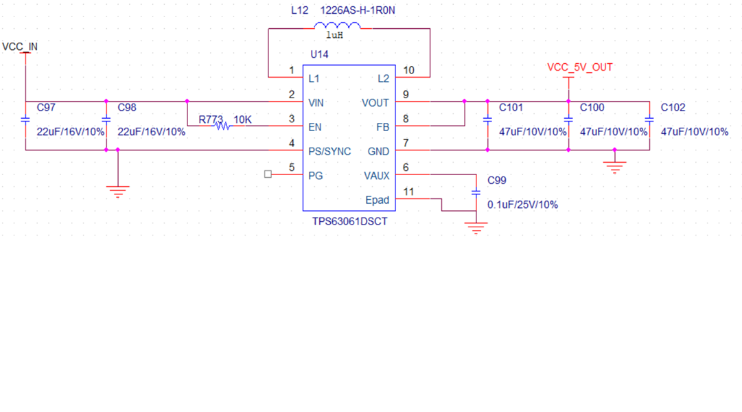

SCH as follow.

    Could you please verify that you are measuring the output voltage on the output capacitor, and that you are not including the voltage drop on the output wires.
    Please also check if the device changes power mode. You connected PS pin to GND, so the device will automatically change the power mode depending on the load current. For small load currents the device will work in PFM mode, with slightly higher output voltage and ripple. You can check the power mode by looking at the output voltage ripple. In PFM mode the ripple will be typically 20 mVpp while in PWM mode it will be a few mVpp. Alternatively, you can also try connecting PS pin to VIN and see if the output voltage will change with the load.

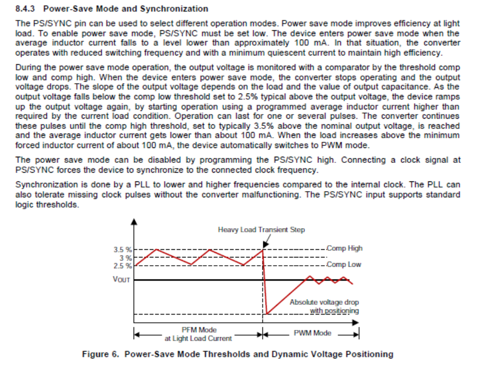

    But I also have a question, the datasheet tell us if PS pin was connected to GND,The device enters power save mode when the
    average inductor current falls to a level lower than approximately 100 mA. But In my design, the minimum load current is 250mA.
    The TPS63061 can't enters power save mode .As shown in Figure.

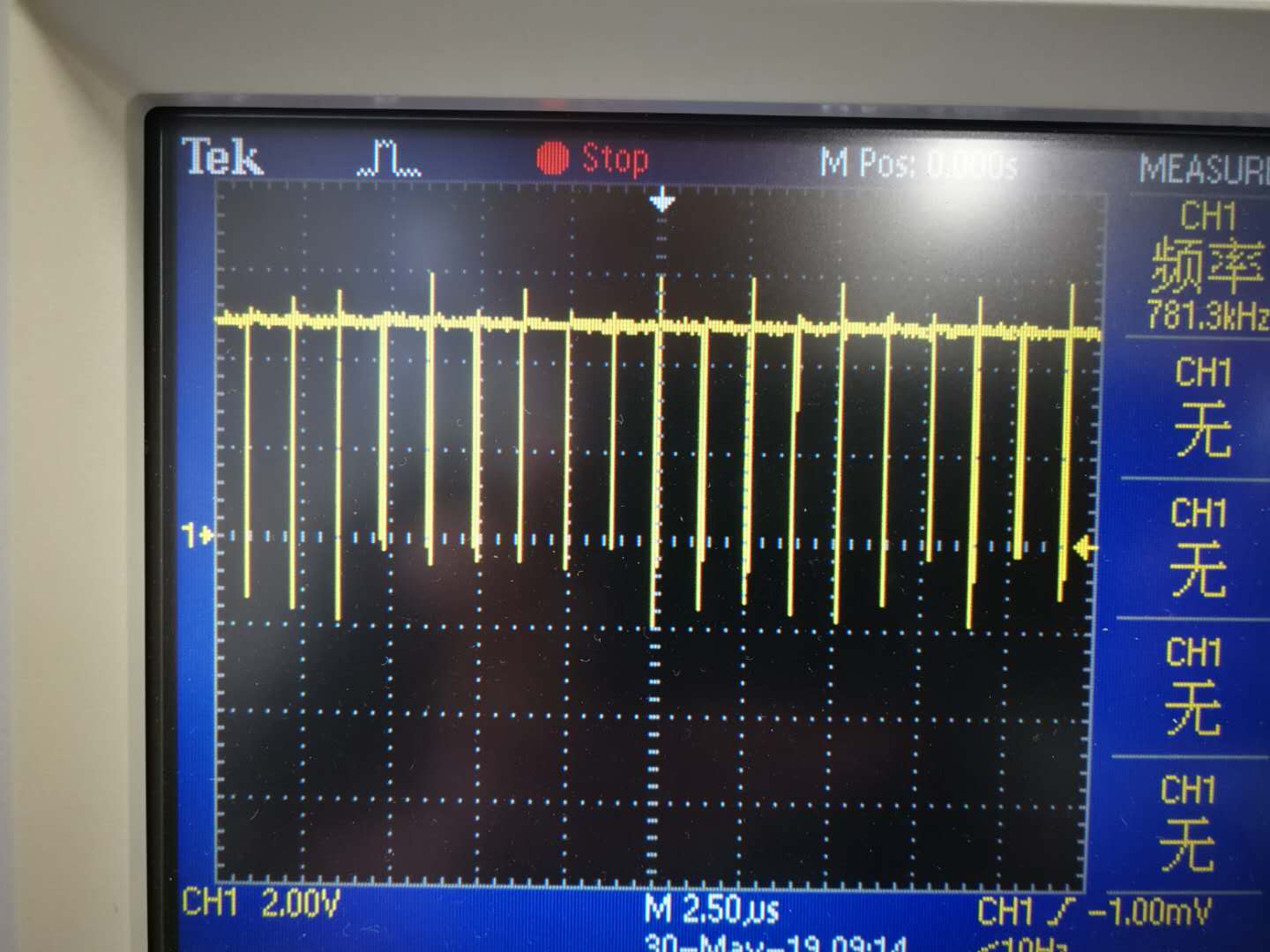

    3、This picture was shown waveform of L1  which load current was 250mA.

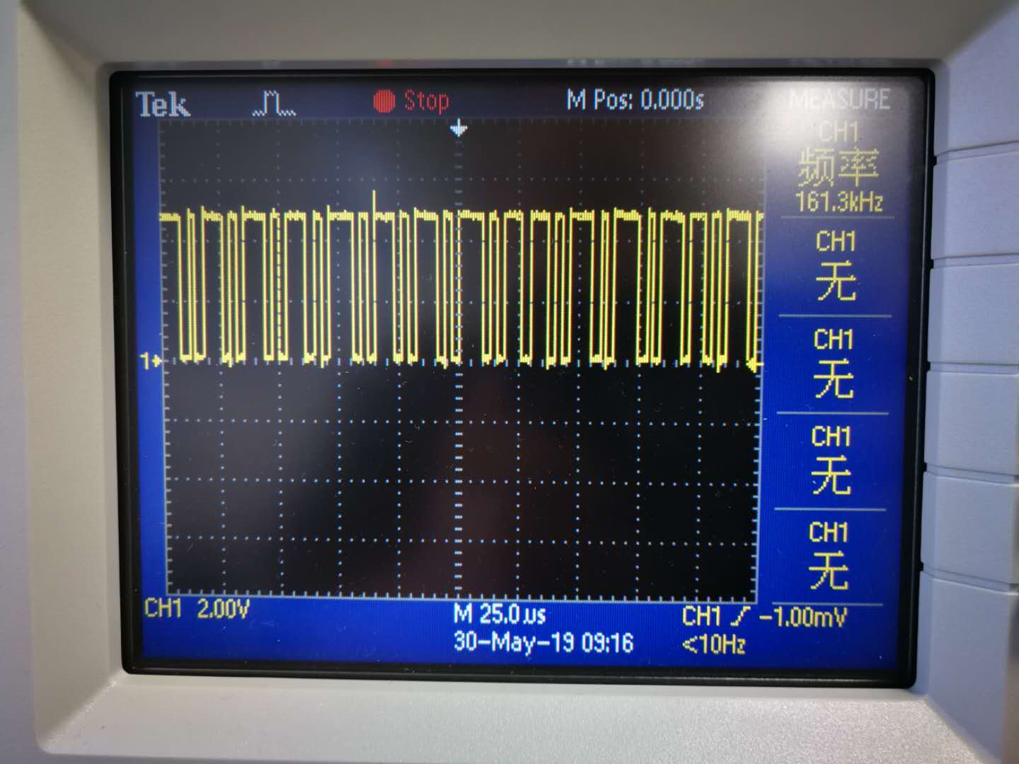

    4、This picture was shown waveform of L1  which load current was 330mA.
    Judged from picture 3 and picture 4 , the operation mode of TPS63061 indeed changed .
