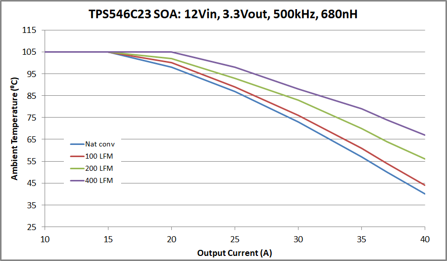

  • Hi Oliver,
    Please see the Safe Operating Area (SOA) Curve listed below:
    Previously the TPS546C23 device was tested on the EVM in accordance to the: "Method of Graphing Safe Operating Area (SOA) Curves in DC-DC Converter" report HERE.  At 30A or below, with the parameters listed in the title of the graph above: Vin: 12V, Vout: 3.3V, Fsw: 500kHz, L: 680nH, the TPS546C23 device was found to be within the safe operating range when operating with an ambient temperature of 105degC.

  • Hi Oliver,
    Please see the SOA curves listed below for this application.  This is based on the proper data set for this condition.
