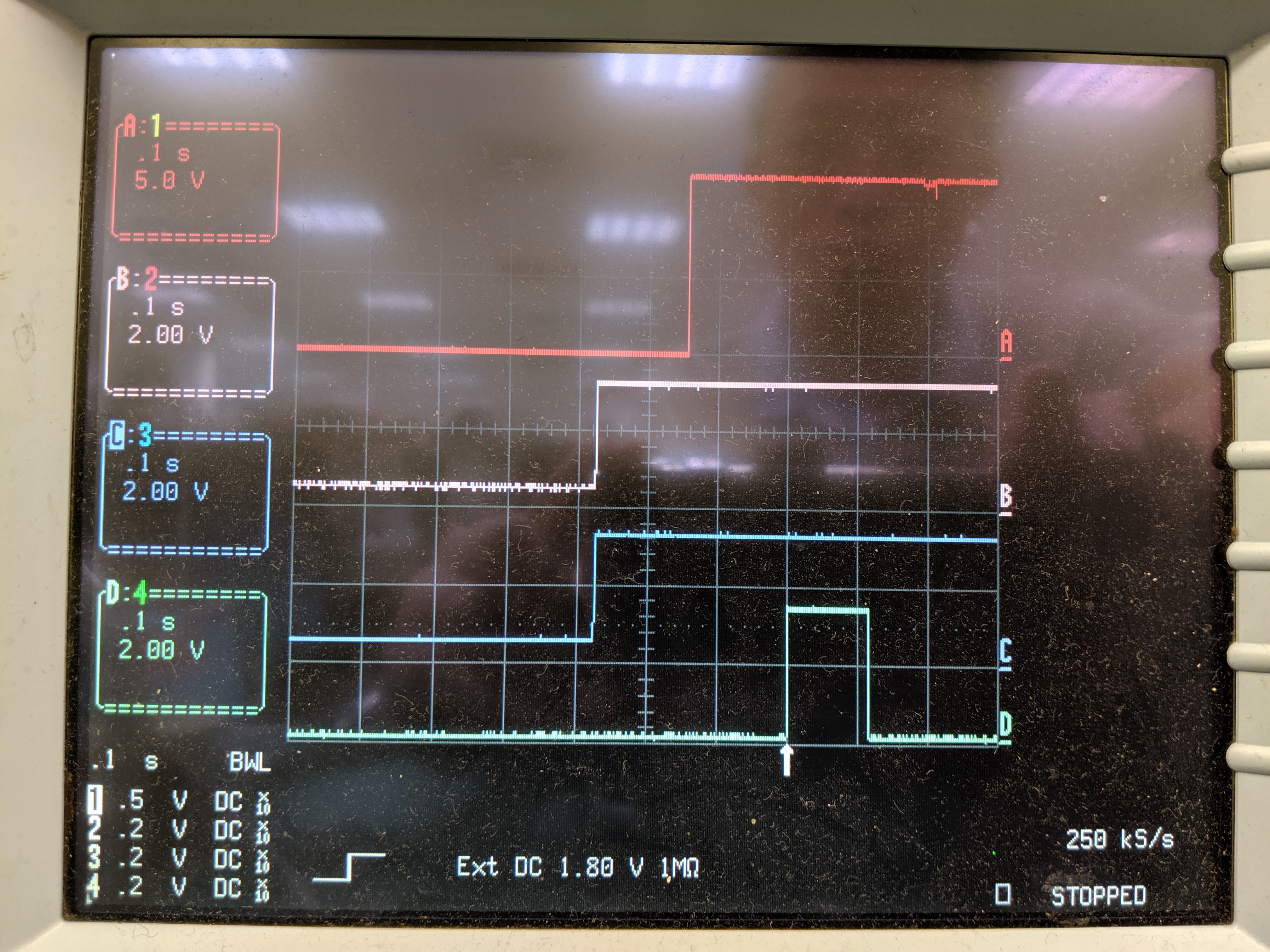

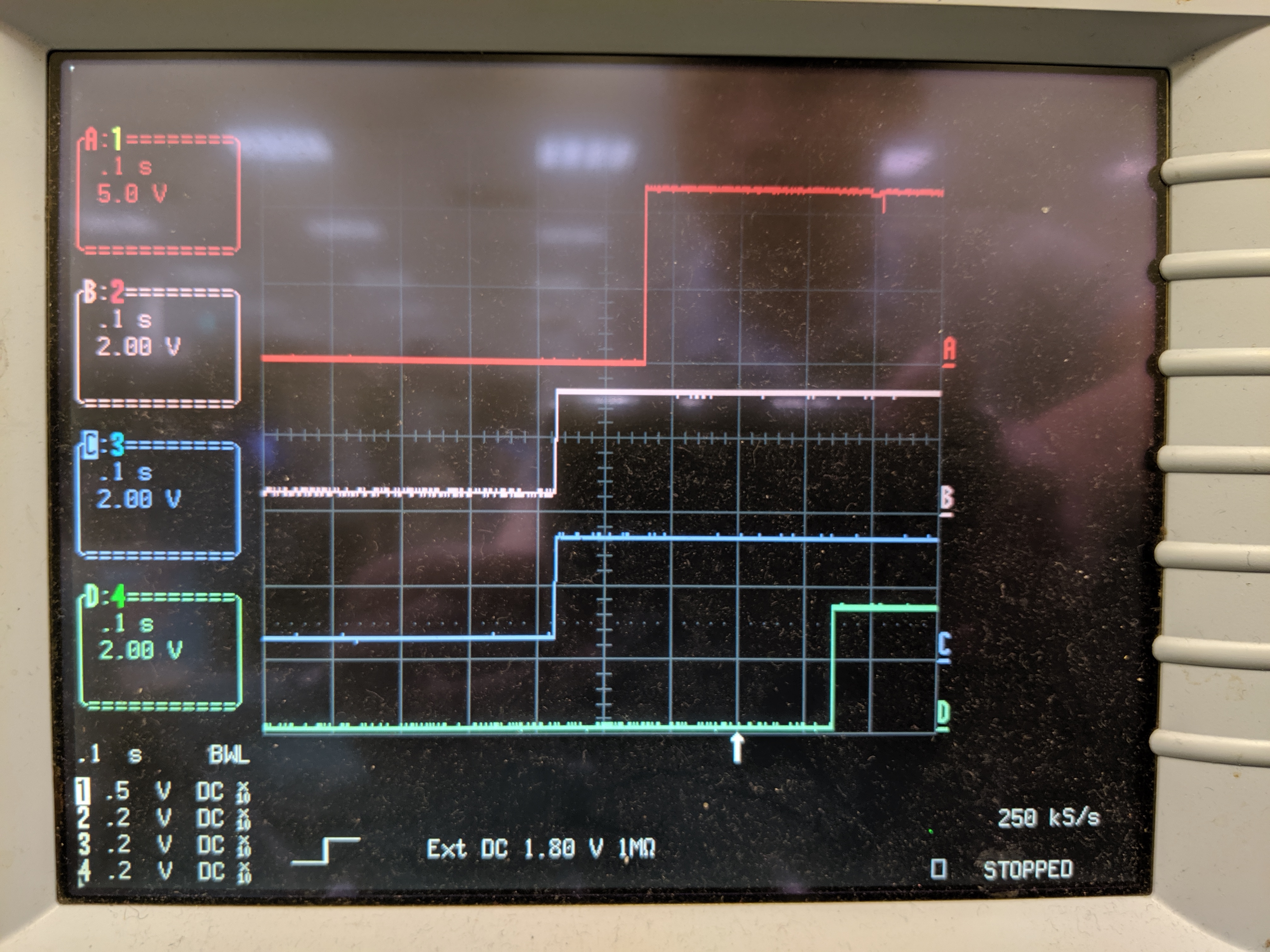

  • Hi, Shirley :
    I'm sorry to jump into your communication firstly.
    Here comes power up sequence waveform. please check it and advise if you have any finding ...
    VIN_VDD_VDDIO_Enable Siganl.jpg  =>
    Ch 1: VIN,  CH2: VDD,  CH3: VDDIO,  CH4: Enable (pin)
    VIN_VDD_VDDIO_Trigger signal.jpg =>
    Ch 1: VIN,  CH2: VDD,  CH3: VDDIO,  CH4: Trigger (standby state: 0x03,  during access register)

  • Hi CD,
    Thanks for the sequence waveform. The power on sequence looks ok. Could you point out at which particular time in the waveform did you write the register? And when are the three particular moments that you read the FSM_LIVE_STATUS register to be 0x03, 0x1A, and 0x03? It's quite strange to see the readback to be 0x1A, which is not a normal value that the device can feedback.

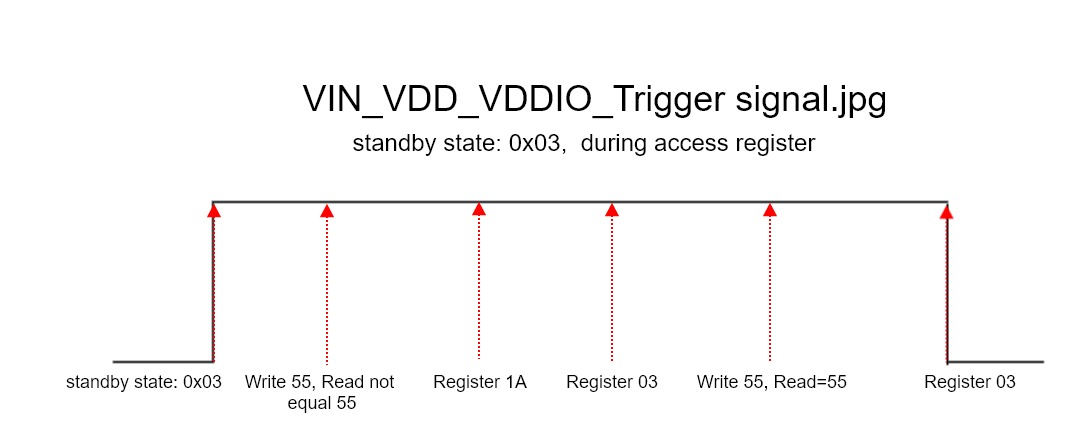

  • Hi, Shirley :
    We added the access timing in the sequence waveform.
    Please check it and feedback your comments if you have any finding ...

  • Hi CD,
    Sorry we still can't figure out the reason and we can't replicate this issue on our board yet. Can you confirm this behavior happens with every device, or happens at just one device?
    I'm not familiar with the oscilloscope that you use. What is the time base in your waveform? 1s/Div or 100ms/Div?
    Besides that, may I ask what is the purpose of writing the brightness code before EN is active?
  • Hi, Shirley :
    Due to functional safety concern, we have to make sure I2C communicaiton can work normally before enable pin is active.
    This is we would write a certain value via I2C and then, readback to comapre its consistency (equal).
    After that, we would start to control LED driver (LP8863).
    As for we got the wrong value after sandby of LP8863, we found it's our software I2C read (function) bug.
    and our software member fixed it immedately.
    It seems everything goes well now.
    I'm sorry to bother you ...
    CD
  • Hi Shirley,
    Per following this issue with RD, they figured out there is something wrong with the coding of I2C reading process. After correcting the problem, there is no problem now. We can close this thread.
