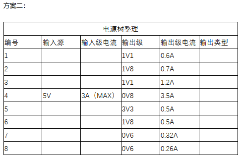

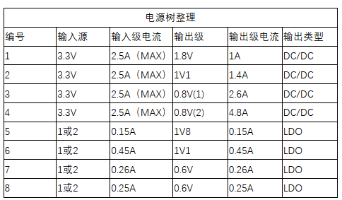

Hi Engineer,
The PMIC chip needs to be re-selected. Can you help me with it, is it more suitable than the TPS65917-Q1?
It is best to be like the MAX77863. The specific parameters are 2.6v-5.5v input, 4 dcdc, 8A, 3A, 2A, 2A, 9 ldo- one 450mA, two 300mA, six 150mA, eight gpio interfaces. , i2c interface
The figure below is the function we need to implement the PMIC;
BRs
Elsa Duan
  • Elsa,
    Can you help us understand what processor you would like to power? We need to know the sequencing requirements of the rail (as well as voltage and max currents) to understand what solution is the best fit.
