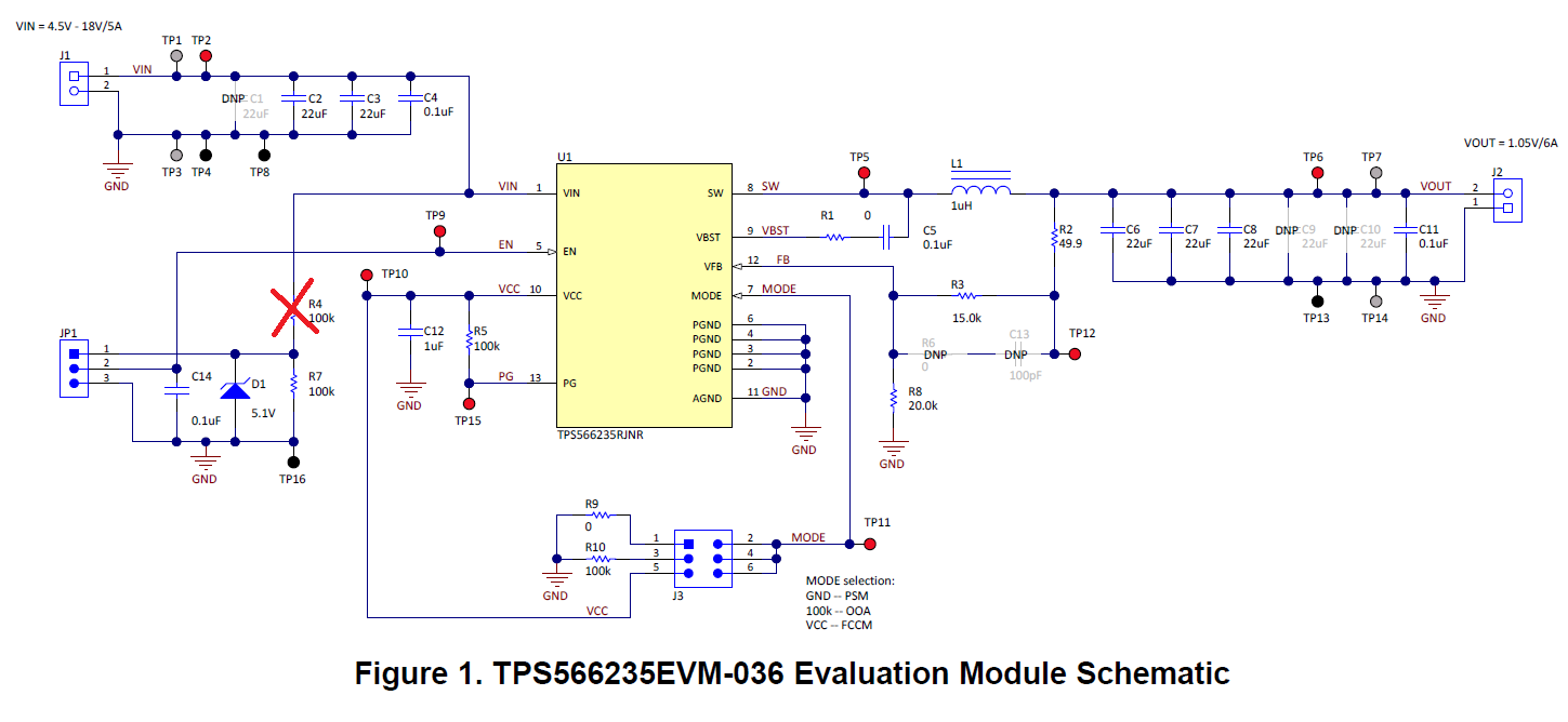

I measure the VIN shutdown current of TPS566235 with 12V Vin and 0V VEN.
The result is 89uA, which is different from the value 3uA in datasheet.
Can you help to check with this value?
Thanks.

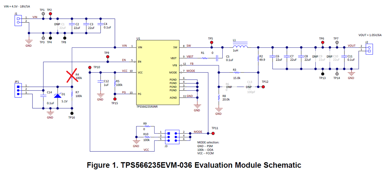

Thanks.
Thank you for your answer.
I remove R4 and measure the input current again.
Input current is 3.3uA, which is correspond to the value in datasheet.
