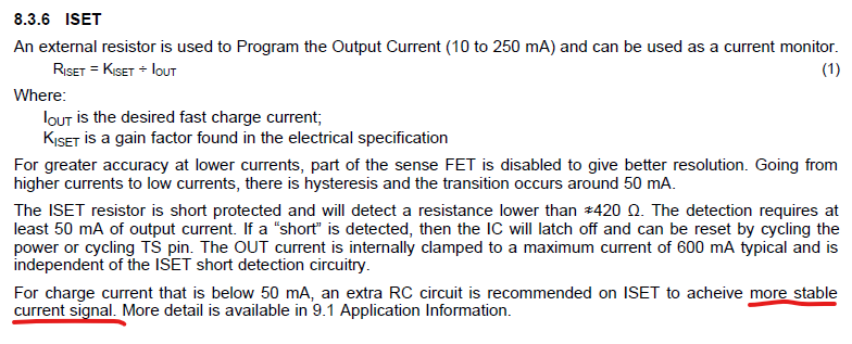

Hi Team,
   I want learn more about the function of external RC circuit when charging current is small, why we need the external RC and how it works. DS mentioned for a more stable current, but it is not clear enough to me.
  And if customer need 10ma charge current without external RC, what's the risk?
  • Hello
    The ISET circuit will sample the current at a low freq rate and this will result in ripple on output current.  The RC circuit will smooth this out to provide a cleaner single.
    Due to the very low current this is only seen at low charge currents.
