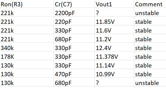

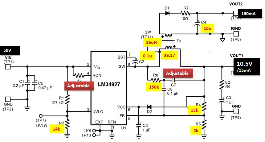

My customer is using LM34927 as aux power controller of their DC/DC bricks. The testing input voltage is 50V and other parameters/output loads are shown below.
They want the VOUT1 to be 10.5V, so they choose the feedback resistors R4/R5 as below ,15k and 2k, according to the calculation.
However, they found that VOUT1 is not 10.5V, and is changing a lot with different R3 and C7. The testing results are shown in the chart below.
Could you please tell us what's going wrong here?
  • Hi Shenhua,
    Use the quickstart file (available by download from the product folder) to calculate the ripple injection component values.
    The ripple injected into the FB node should be 20mV pk-pk at min Vin. Higher ripple amplitude (by decreasing the cap) causes a corresponding offset on the output voltage equal to half the ripple amplitude gained up by the feedback divider ratio.
    See app note snva874 for more detail.
    Tim
