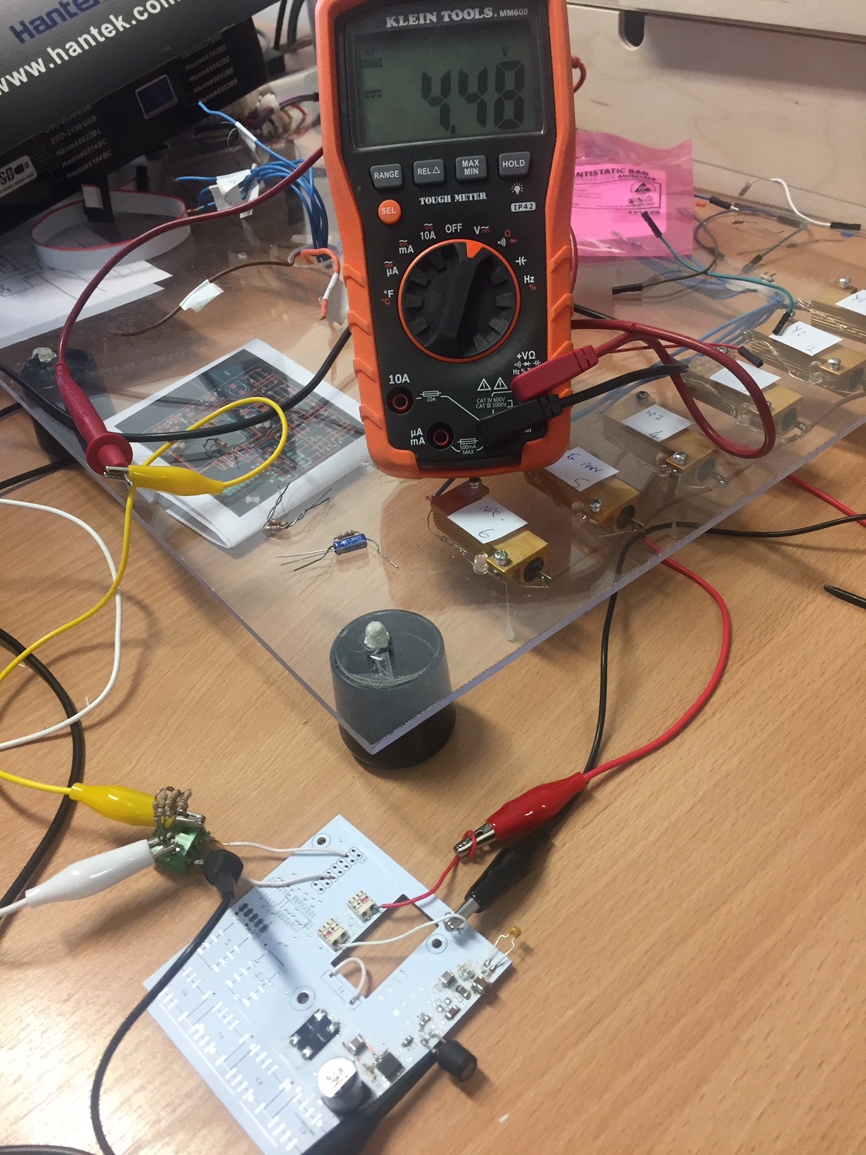

Im using the default webench design for the LM46001 (500khz 5 v out) and have produced a pcb. I have not placed the Capacitors really close to the IC but nearby. I am not getting the voltage regulation I expected with omnly 4.49v out not 5v. On load (300mA ) the voltage collapses. If I change the Rfb to 230kohm (not 255kOhm) I get a better span of voltage with loads. But this seems to be a case of positioning or suffer the sensitivity issues. Has anyone found this before?
