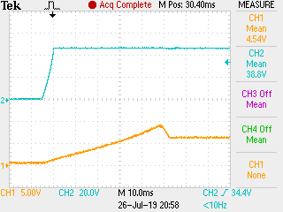

    I have added 10uF on top of 22uF. Now the circuit starts. And here is the waveform at room temperature of the start with VDD1 in blue on top and VC in orange on the bottom:
    It seems VC is rather low at a little over 6V?
    BR
    Michael
  • Hi Michael,
    I agree with artem's comments; also, the falling UVLO for VC is 5.4V so 6V is cutting it close.Since the EVM uses a different transformer, I believe your R551 resistor may be too large as well. You may consider decreasing it maybe start with 50 ohms first to get some margin above the Vc UVLO.
