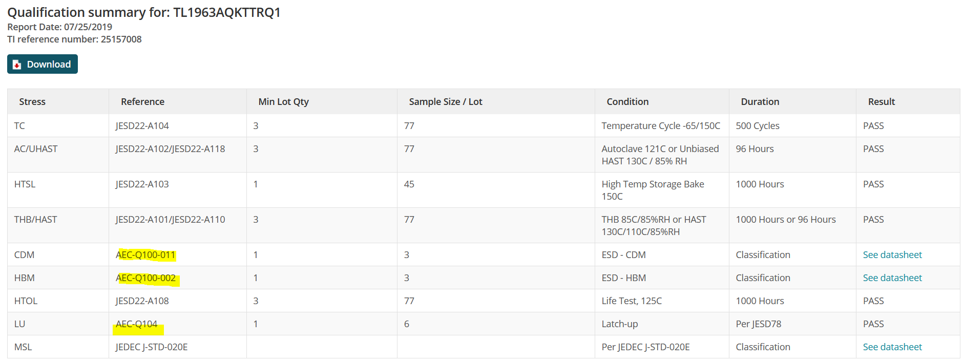

Hello ,
Can you certify that the TL1963A-Q1 is fully AEC Q100 qualified ?
Thank you for your support .

Hi Liouaeddin,
For qualification-related questions, you may go the product page of the LDO and under "quality and packaging", you will find the qualification information on a device.
Here is a link to take you to the "quality and packaging" page:
Then look for the link labeled as "Qualification Summary", you can then find the information you need.
Here is a screenshot for the qualification information.
