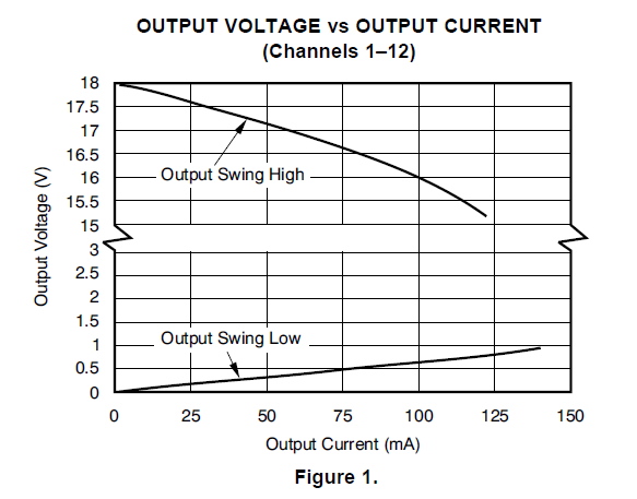

My customer is evaluating BUF12840. At this time, I would like to make sure about
output source/sink current. Please give your advice.
They are using 1ch output under 104mA source/sink.
Other 11ch are using several mA, only.

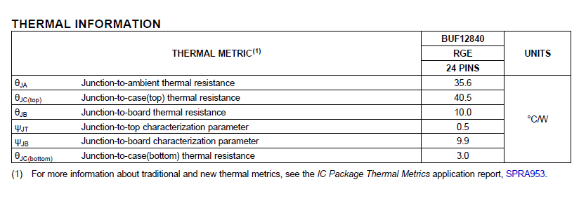

They have measured Tc temperature, it was 50 deg.C under Ta=25 deg.C.
Is it no problem to use over 100mA output source/sink for 1ch to be well
considered about the heating issue?
