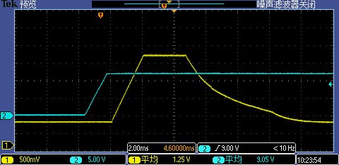

  • Hi teams
    I have returned the NG units to FA team and the bench test result shows that all function is normal in TI'a lab.
    The reason why I didn't do the bench test in the field is that I can't find EVM for this device.
    Below is the details update about this case:
    During powering up procedure:
    1. BUCK1 output VIO PIN37 have ramped up within 3ms reach 3.3V.
    2. BUCK2 didn't use in the customer system.
    3. VGL didn't have any output. I have measured DRVN PIN21 no switching waveform at all
    4. The BUCK1 also been turn off seems the device is been latch off.
    I have several questions:
    1. If BUCK2 isn't used in the system. Do we have to disable this channel through I2C or EEPROM in REG00H?
    2. The customer left the BUCK2 SW node and sensing pin (Vcore & SWBK2) floating. Are this configuration is correct? What's the recommended connection for not use channel?
    3. Customer also connect a 100nF cap between PIN 40 and PIN39 (BK1SW and NC pin) are this matter ?
    4. Are this issue may lead by abnormal EEPROM writing? how to verify about this?
    The BUCK1 output waveform is shown below Yellow (VIO) Blue (Vin)
     E.GC.TCON.43001B维修原理图 (1).pdf
