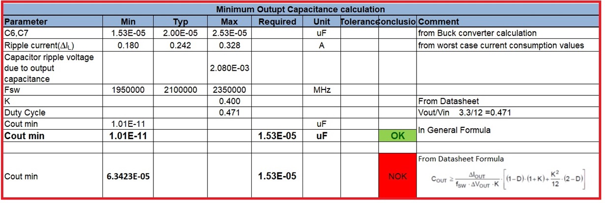

LMR36006FSC3RNXTQ1 3.3-V Fixed 2.1MHz 0.6A
Cout Value from the formula 63.42uF
From Datasheet it not exceed 15uF
In our Design we used 20uF, Please check our calculation is wrong or datasheet formula is wrong.

The formula depends on the load transient performance that you desired on the IC.
Therefore the value of 63uF could be due to a small value of delta Vout that you put into the equation.
In general, the value recommended in the datasheet is what we used to test based on stability and transient performance.
