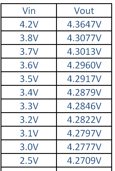

In our design, the output voltage is very close input voltage. The FB of the divider resistor is 825k and 110k. The output voltage should be regular at 4.25V. But I measure the actually output voltage is different. Please refer below.
Vin=4.2V, Vout=4.55V
Vin=3.8V, Vout=4.44V
May I know what is the minimum duty for this device?
Does the TLV61220 has pass-through mode during Vin>Vout?
What is the maximum voltage to keep output voltage in regulation?

  • Hi Minqiu,
    Thanks for your support. The schematic show in below, We have remove R95 as a no-load condition. The test data show in below.
    In the no-load condition, why the output voltage still have big different from 4.27V to 4.36V? I think it should be regular at around 4.25V.
    BR,
    Gary
  • Hi Gary:
    According the test result, the Vout is much closer to your target.With no load, the converter will enter DCM, which is similar with PFM. Normally the Vout will be higher than loading for this mode. And please notice the FB voltage has a range and about 6% peak to peak tolerance. Details could be checked in datasheet.
