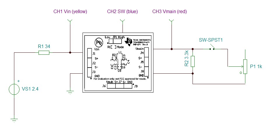

  • Ok, here are my measurements.
    Circuit topology is as follows:
    - 2.4V supply with 34 Ohms serial resistor connected to EVM Vin (yellow trace)
    - 3k3 Ohms connected as load in parallel with a 1K poti (red trace)
    - SW input (blue trace)
    - LDO not activated (activation would make things even worse!)

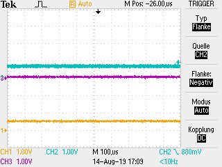

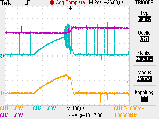

    Figure1: Normal operation with ~2mA source current (3k3 Ohms left, poti disconnected)

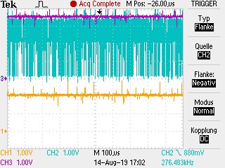

    Connecting the potentiometer and slowly decreasing the resistor value until source current reaches ~ 30mA (overload). Source current jumps up to ~50mA.
    Figure 2: Shorted output. Source current is >50mA.

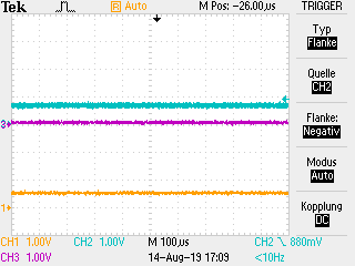

    Figure 3: Removed short/poti (3k3 Ohms resistor still connected)
    >>> Vmain does not recover anymore!!! Converter is not able to startup with 3k3 Ohms load! What's wrong here?
  • Hi Stefan:
    Sorry for delay, as it's public holiday here. Thanks for your updated, It's clearer with the waveform. And there are two detail need to be checked: the channel 3(red) is connect to the power supply or Vin pin close to the converter? And what's the source current for this figure?
    I'm out of office these days, so ll ask the help of my teammates, to see if it is available to reproduce this issue in our lab. Please wait with patience. Thanks a lot.
  • Hi Minqui
    First of all, thank you very much for your ongoing support.
    - Channel 3 (red) is connected to Vmain pin.
    - The current measured from VS1 for figure 3 is 64 mA. (Please see the picture below for the setup).
  • Hi Stefan,
    I observed similar behavior, it is hard to detail explain how does the device enter such latch up status. but the conclusion is that the input current during during startup is too high for a 34ohm source, so the device can't finish startup and enter normal operating condition. the only solution is reduced the power supply impedance and reduce the loading during startup.
