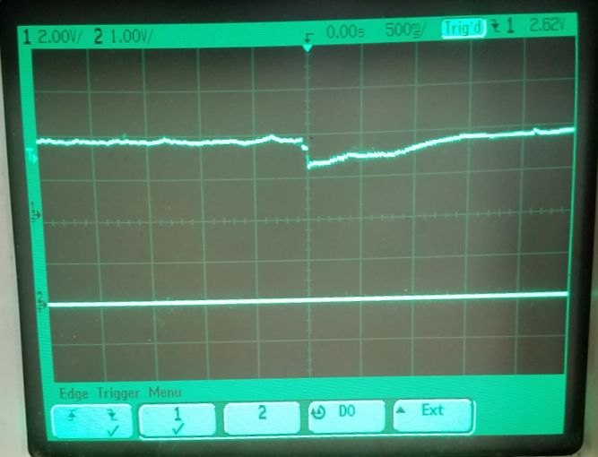

I am having some strange issue with BQ24166 in that if the USB input voltage is any higher than 5V (this threshold varies slightly board to board but it is right around 5V) the output becomes very unstable.  Here is what i mean:
Switcher Voltage output (VBAT from circuit below) when USB < 5V:
Switcher Voltage output (VBAT from circuit below) when USB > 5V:
Both scope plots above you are looking at a time when i power on the board at the trigger point, you can see the < 5V image there is basically no droop on the output and it just stays pretty consistent, if i zoom in i can see a miniscule droop during the inrush current.  For the USB > 5V you can see the output is already lower and highly unstable then when i power on the board the inrush current pulls the voltage low enough to cause the board to brown out and turn off allowing the voltage to rise again.
I am not sure what the issue is, it is fine at 5V and lower but the problem is i can't control the voltage supplied by a given USB port and often times they are slightly above 5V, so when that happens the board just won't run without a battery.

Any ideas what i have done wrong or what the problem could be?  Note i have tried swapping C99 to a 47uF capacitor to no avail.

    DRV pin requires at least a 1.0uF capacitor.  Since DRV provides power to all of the logic circuits, if it isn't stable, I can't predict IC operation.  Also, R208 is too small.  ICHARGE = KISET/RISET where KISET=490Aohm.
    Also, since it appears that you are using only 1 of the 2 inputs, just curious why you chose the BQ24166?  The BQ25606 might be a better choice.

    Thank you so much for the quick response!  The DRV capacitor definitely fixed the issue I must have missed that!  Also i fixed RISET I think I misread KISET as 490mAohm so my bad there.
