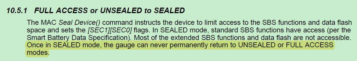

    1,I have one question about unsealed mode. I noticed that there is one description that FG can't return to unsealed mode from sealed mode like below. But I also saw that document gives method of changing to unsealed mode. So I have some confusion.

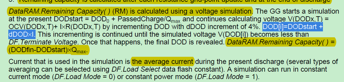

3,in SLUA450, on page6, why is DOD[i] calculated by below formula?  Because I think the unit of left side doesn't match with one of right side.
DOD[i]=DODstart + dDOD*I.

    1. Once in sealed mode, the gauge will always return back to sealed mode if a reset command or POR is done. The only way to permanently unseal the device is to put it in full access mode using the keys and then reprogram the fw.

    3. dDODxI refers to delta DOD at the current, not exactly the multiplication. So, the units are the same. DOD is calculated under load therefore the load current is required here.
