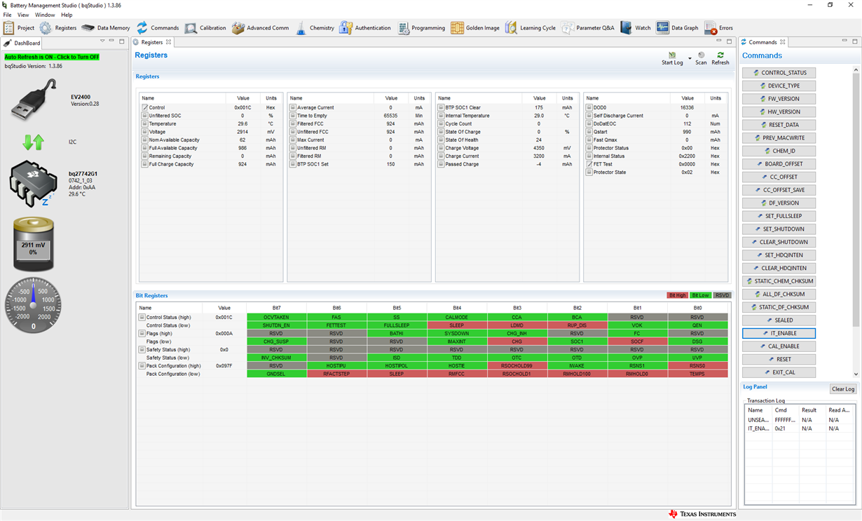

I started using a BQ27742-G1 in one of my recent designs. While the part works flawlessly as a protector, I experience difficulties making it work a s a gauge.
I'm trying to get complete manual learning cycle with SDI INR21700-40T.
I entered the cell parameters, programmed similar chemistry (took SDI INR21700-50E from latest chemistry update).
Went over discharge and relax, but when the relax time came to an end, I've got Error: [QEN: Not Set] [RUP_DIS / RDIS: Not Clear]. Update Status remained 0.
After reading forums I understood that I need to set QEN by issuing IT_ENABLE command. Manually, during relax, by analyzing data graph, seeing stable voltage. Is that right?
However, whatever I tried I was unable to get QEN=1. Of course, gauge was unsealed (both FAS=0 and SS=0, tried also only SS=0). Tried after reset, after complete power-down with cell removal. What am I doing wrong?
Another question: what drives RUP_DIS flag? should I do something to manually affect it or it is managed automatically during learning cycle?

  • Hi Boris

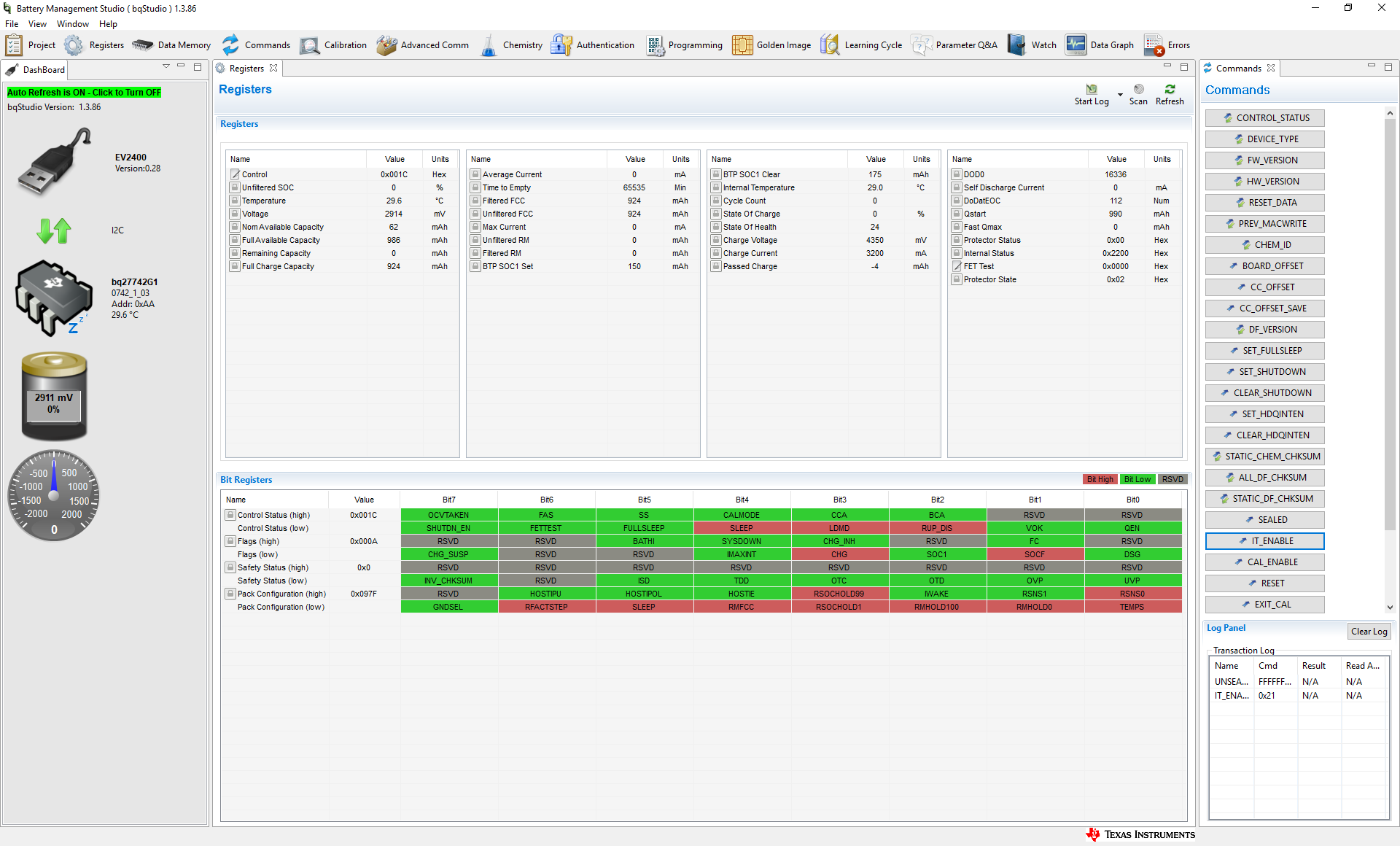

    Qen will get set by sending the IT enabled. Are you clicking the IT_enable button in command
    Can you take a screen shot of your register window.
    The gauge controls the rup dis flag. Issuing a reset command sets rup dis flag. Don't use the learning cycle plug in to do learning cycle. It doesn't always work.

  • Hi Onyx,
    I'm clicking on IT_ENABLE button and actually nothing happens. I tried to do manual refresh of the Control Status register and saw the same QEN=0. Onyx, You suggested not to use learning cycle plug in, but how can I perform learning cycle otherwise?

  • Hi Boris,
    Can you attempt to reprogram the default firmware on the device to see if it will accept the IT enable command?
