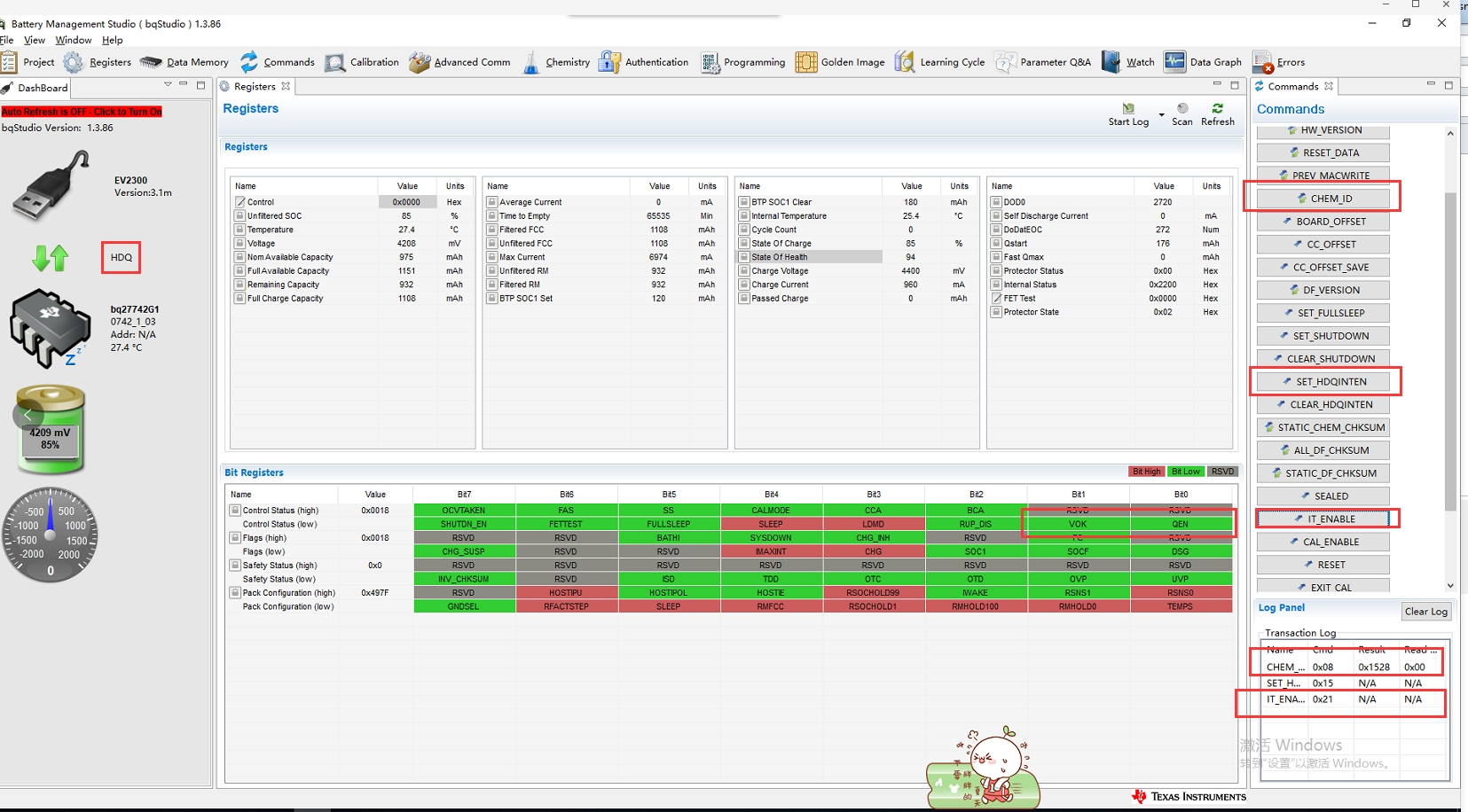

In the I2C communication state, calibration and impedance tracking can be turned on, but after modifying the protocol to HDQ, calibration and impedance tracking cannot be turned on.Is there a solution?I need some help.Thank you very much!
hi
The order of things is to complete every evaluations in i2c mode and only before shipping do you put the device in hdq.
