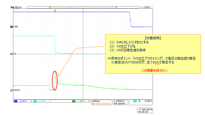

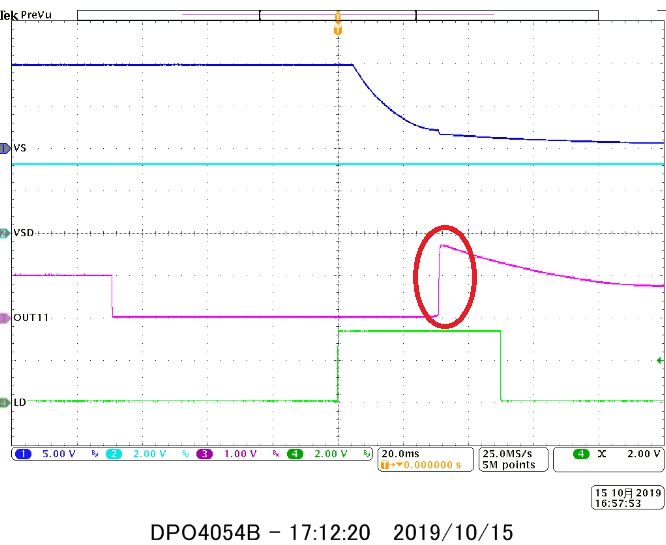

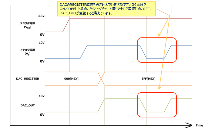

My customer is considering the DAC OUTx control by VS OFF/ON.
- VSD(Digital supply) is applied always. So not related to POR.
- DAC OUTx outputs based on the internal resister setting, not 0V.
- DAC OUTx will be controlled by VS(Analog supply) OFF/ON.
So, I would like to make sure following;
1) Is it no problem for BUF12840 under this kind of usage?
2) Please let me know if you find any side-effect or concern under this kind of usage.
