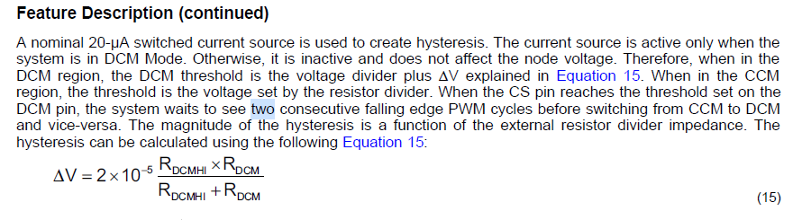

  • Hi Marc
    I can't say for definite but I doubt that a 220ns time constant could be the root cause of the issue. The system waits for 2 falling edges before making the transition from CCM to DCM - see the DS extract below.  I cannot be certain of this but I doubt that a small amount of noise filtering on the DCM pin would have much effect.
    If you transition from high load to low load really fast then it is possible that the output inductor current could go negative during the 2 cycle wait state so this is where I suggest you look. Without knowing exactly what is going on it's not really possible to suggest a solution but things to consider would be
    Reducing the load transient rate
    Increasing the DCM threshold
    Adding some TVS devices to absorb the avalanche energy at a safe voltage
    Increasing the value of the output inductor
