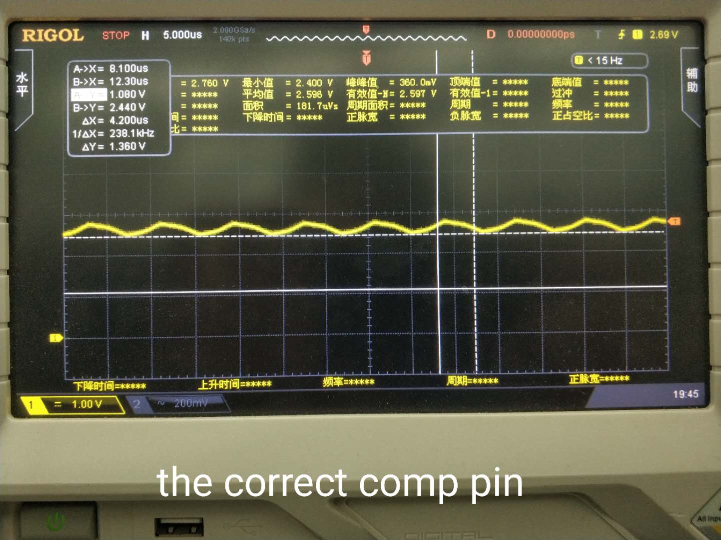

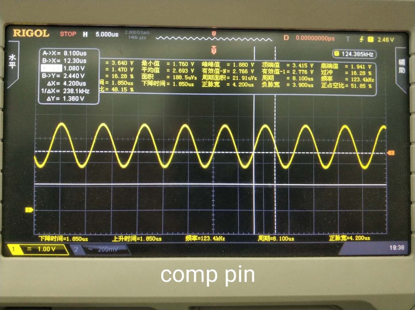

An TPS40170 Buck Circuit which conversion 48V input supply to 24V output with the maximum current about 10A, there are something trouble with the circuit,
1. some boards (about one in ten) will be stopped to supply 24V to loads about 150 Watt,
2. few boards (about one in twenty) can be heared that the power conductor is whistling when connected loads,
Would you like to give me some advices for the troubleshooting, as I tried some compensation loop adjust, but it didnot work.

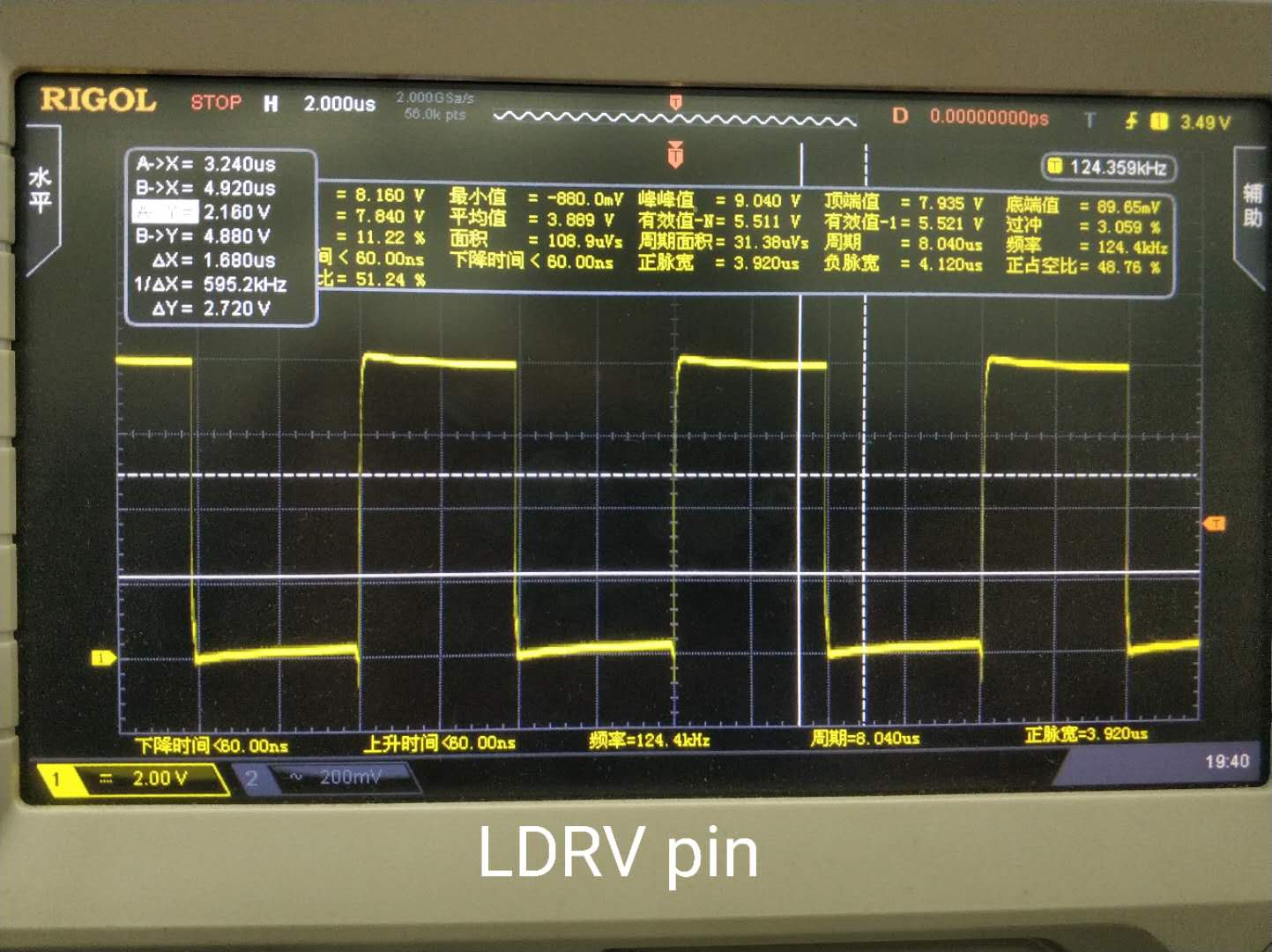

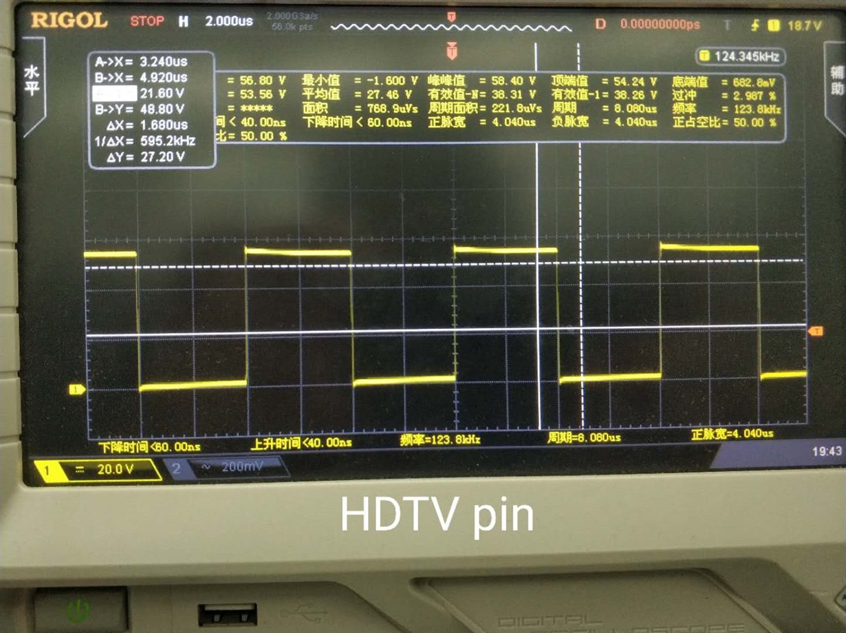

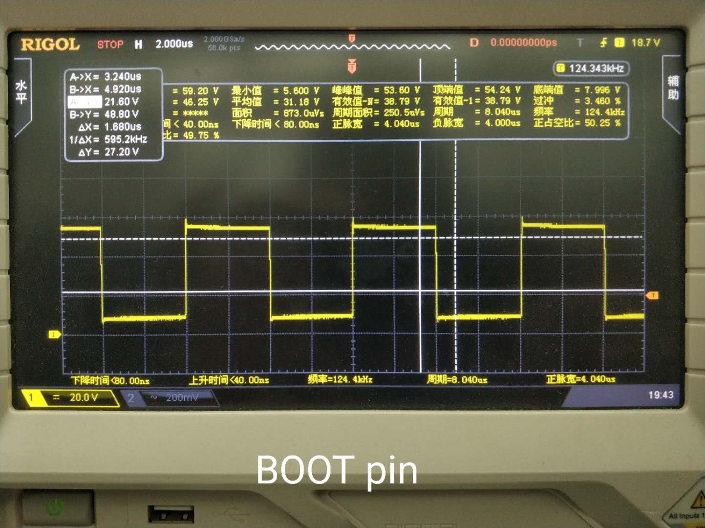

There are some waveform test of TPS40170 pins:
The comp pin, I think the below is right (The waveform is the comp pin of an EVM board)

    I have a quick look at the schematic, C34 and C35 voltage rating should be 50V or higher, calculate compensation with effective capacitance with 50% derating.
    Can you measure loop response  on R29? if you don't have the proper instrument, then do load transient testing with shortest thick wiring on output, load step from 1A to 6A at 1A/us. pls refer to below note:
