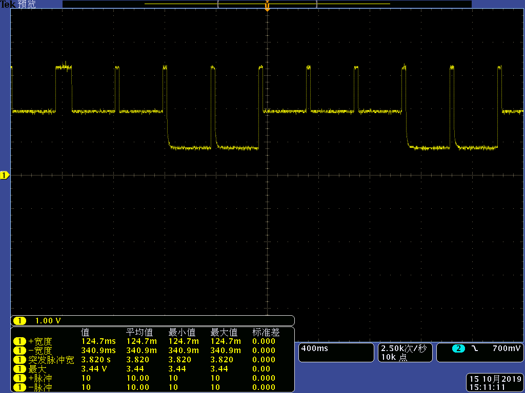

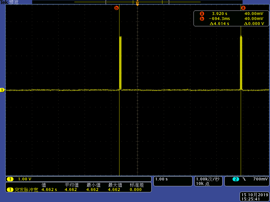

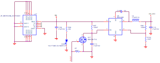

I have a new problem.When the device is in standby mode.
Why the period of DPWM signal is different from that of SLEEP?
Why is the waveform of 3v3_VCC unstable?
This is the waveform of SLEEP signal.(Its period is 360ms.)
This is the waveform of DPWM-A signal.(Its period is 4.6s.)
This is the waveform of 3V3_VCC signal.(Its period is 340ms.)
This is the circuit diagram.

Hello
This is a power saving mode used during standby. The unit will turn off the 3.3V if no RX is detected.
The waveforms look normal.

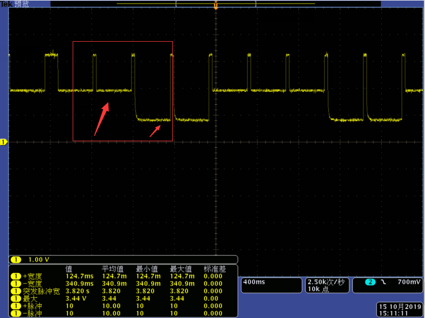

HI Bill!
1.I know this is a power saving mode used during standby.
But I don't understand why the waveform of 3V3_VCC is irregular. Is it normal?

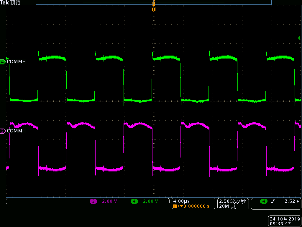

2.Another question, is the comm signal of bq500211 correct?
3.Last question, is the comm signal of bq51013b correct?

Hi Zhetao Xie
The first photo is 3.3V bus --- this is normal behavior, voltage is off during the low time and bus is high impedance slight changes in load will result in large change in low level.
The 2ed and 3ed Comm photo -- This looks normal, comm is occurring at a about 2kHz and is modulation of the operating freq. What is captured in the scope shot is operating freq.
