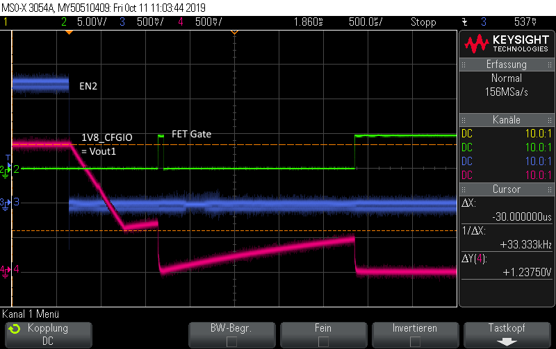

Observation1
I start to shut down rail1 by setting EN2 to 0.
Depending on the programmed slew rate Vout ramps down more or less slowly.
If configured the slew rate is too high, then the LP stops ramping down and
Vout1 starts ramping up again while EN2 is still 0 !
In order to enforce a quick shut down, I do shortcut Vout1 to GND using a strong FET.
In my test case this happens 1ms after EN2 got 0.
Vout1 immediately (20us) drops to near 0V.
After 60us the FET is switched off which removes the short cut from Vout1.
Vout1 now starts ramping up again while EN2 is still 0 !

    I have measured EN2 and  Vout1 at the Oscilloscope and I can see that Vout1 immediately starts ramping down when EN2 goes low.
    So it should be the right configuration in Register 0x04 regarding EN2 control.

    PS: Below some screen shots and the register setup...
    The AC disortion on EN2 results from a small wire to connect the probe to the EN2 PCB trace. The EN2 signal on pcb board is 'clean'.
    The same image showing also the current (Inductor current of the main 5V Vin regulator)

    Despite of excessive capacitance on VOUT1 the VOUT1 ramps down until 0.6V as expected. But after that something sources more voltage to the output. Also interesting notice is input current waveform. How voltage behaves on input side of the device? Does the input voltage go lower than specified UVLO limit 2.4V? Anyway if BUCKx is controlled by any method, pin or I2C, the disabled BUCK should not draw any current from VIN.

    The primary regulator gets an UVLO. As soon a s I shoot down the second stage regulators the 5V capacitor voltage ramps down in a linear manner from 5V down to about 2.7V within 350us. This corresponds to a high constant current of about 12A drawn from the 5V rail.
    Then I investigated if the primary regulator actively discharges the 5V output capacitors while in UVLO. Therefore I measured  the current through the inductivity connected to the switching output of the first regulator (Agilent 50MHz DC current probe) . This current immediately drops to 0 when the first regulator is turned off and does not get negative. So there is no active discharge of the 5V capacitors by the first stage regulator.
    Then I investigated what happens to the second stage regulators (LP8758).
    So I triggered the emergency shut down procedure on the second stage regulators while leaving the 24V connected and the 5V regulator working.
    Furthermore I stretched the time between setting EN low and shortcutting the LP8758 Vout with a FET.
        > Does the input voltage go lower than specified UVLO limit 2.4V?
    Therefore  in the screesshots Vin=5V is alive and up due to the fact that the first stage regulator is still working.
         > Despite of excessive capacitance on VOUT1 the VOUT1 ramps down until 0.6V as expected.
    This depends much on the programmed slwe rate. If you select the fastest slwe rate of 10mV/us then the Vout only ramps down by about 0.3V.
    I didn't check if in this case Vout also ramps up again.  If you select a slower slew rate the voltage ramps down to a lower level before ist stops.
    If you select 1900uV/us and slower it ramps down to 0.6V.
