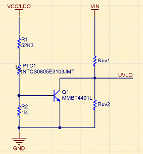

I am using the LM5116 for buck converter. I need to protect the circuit from temperature. The IC has protection but it doesn't matter to my application.
* I will use NTC. Using the NPN transistor with serial diode, i will keep the UVLO between 0.4-1.2V. The system will then enter standby mode. I'm thinking of working with VCC on IC. My question is;  Can I use this circuit smoothly with VCC?
Do you have any other suggestions for this (with NTC)?
* I'm thinking of using this protection circuit for LM5122(for boost). There is an overvoltage protection circuit for the LM5122. I want to apply both. (OTP and OVP)
Is it correct to manipulate UVLO.
