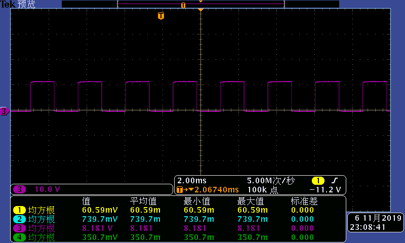

I meet a problem when using LM5104. Let me express the condition.
When the pin LO is not connected to the gred of a mosfet, it's output wave is right(P1). But  as soon as i connect it to a mosfet with a 10Ω driving resistance,the output wave is wrong(P2).
When the pin IN is connected to gnd, according to the datasheet, the driving signal should be 1,and it is really 1 when LO is not connected to the gred of mosfet. but it becomes 0 when LO is connected to the gred of a mosfet.
Thanks for your help.
Li Yang

    I see in the second waveform the signal is not as high as expected, but it looks like it is going to some level above ground. There could be something in the circuit that is causing this behavior. Are you operating the driver with the power train connected with only the low voltage applied to the driver and no high voltage or load on the power MOSFETs?

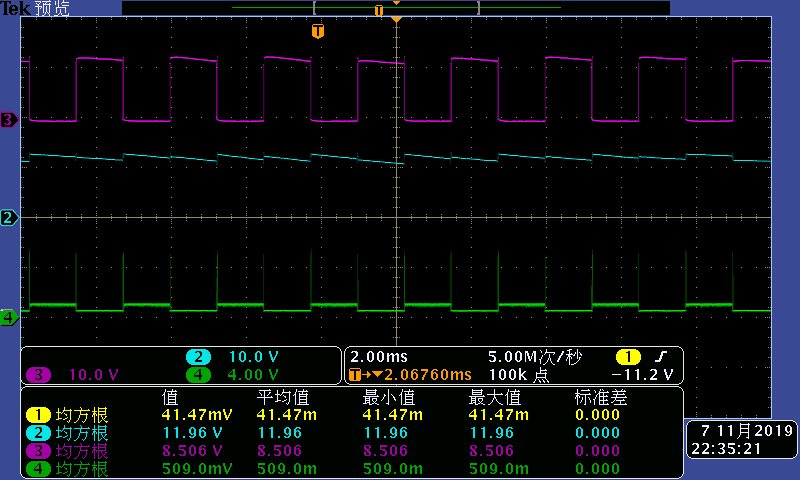

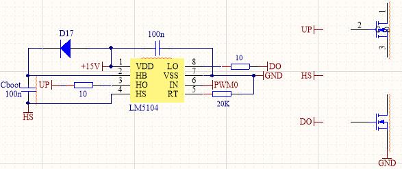

  • Dear Richard:
    Thanks for your reply. I am sorry for my less detailed discription and i will express my problem exactly. According to the datasheet, i build the Circuit.
    PS: Vds=0
    1.When nothing is connected to Mosfet, the output of pin LO is right.
    2.When DO is connected to a Mosfet, signal of the Mos‘ GS becomes wrong.
    3.When DO, HS, UP is connected to Mosfets. In this circumstance, the signal of Vgs of the up Mosfet is right but the down Mosfet's is wrong. By the way, according to your suggesstion, when connecting the switch node to ground, waveform of Vgs-up is right.

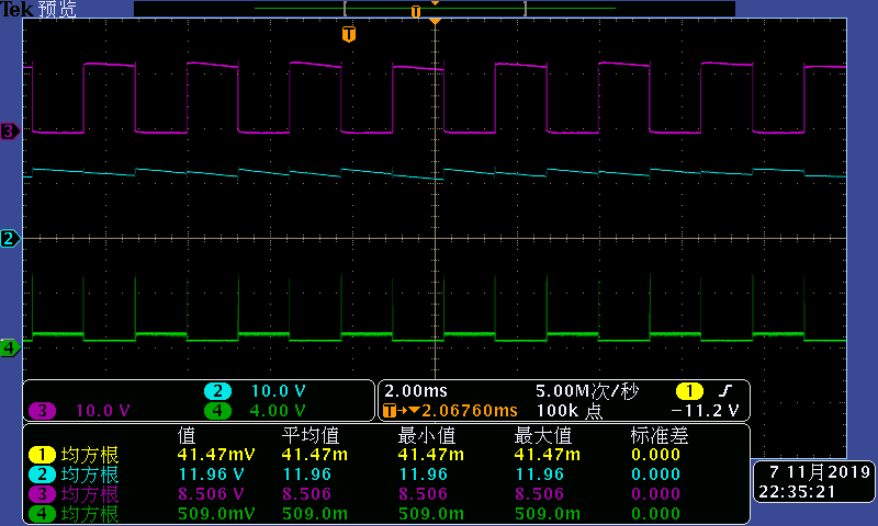

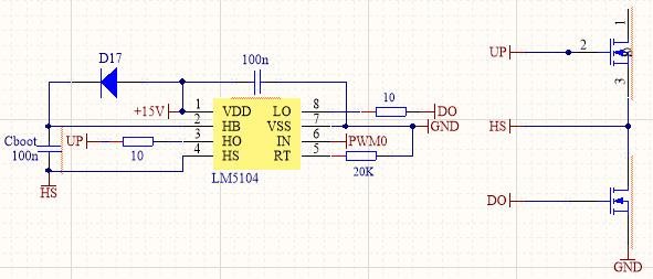

  • Dear Richard:
    I feel very sorry that the reply just now cannot disply images. So i send a new one.
    PS: Vds=0
    3.When DO, HS, UP are connected to Mosfets. In this circumstance, the signal of Vgs of the up Mosfet is right but the down Mosfet's is wrong. By the way, according to your suggesstion, when connecting the switch node to ground, waveform of Vgs-up is right.
    Violet: waveform of Vgs-up
    Blue: waveform of Vcboost
    Green: waveform of Vgs-down
    Thank you for the more detailed waveforms and schematic. It appears the HO output and timing seeing the LO rising to some lower level seems correct.
    The LO output seems like it is being limited to a low level by something in the circuit. Can you confirm the connections and make sure there is not some unintended low resistance at the low side MOSFET gate? Disconnect the driver LO to the low side MOSFET gate and connect a DC supply source of 10V to the MOSFET gate and source. Confirm if there is very low current flowing with the 10V applied to the MOSFET gate to source.
    You may want to confirm the LM5104 with a new device installed, if the MOSFET gate and source are confirmed to be high resistance/low current.

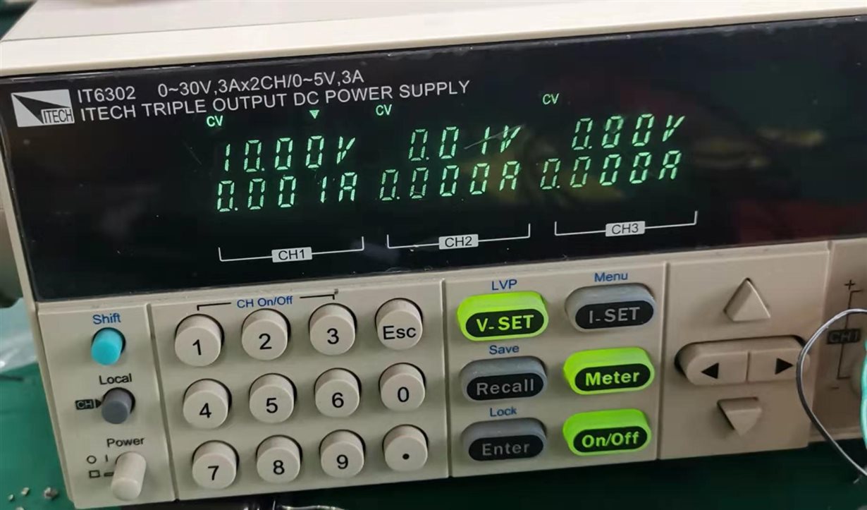

  • Dear Richard:
    According to your suggesstion, I disconnect the driver LO to the low side MOSFET gate and connect a DC supply source of 10V to the MOSFET gate and source. Voltage of Vgs is right(10V) and there is very low current flowing with the 10V applied to the MOSFET gate to source. The same phenomenon appears when the DC supply source of 10V is connected with a 10Ω  driving resistance. This may show that there is not some unintended low resistance at the low side MOSFET gate.
