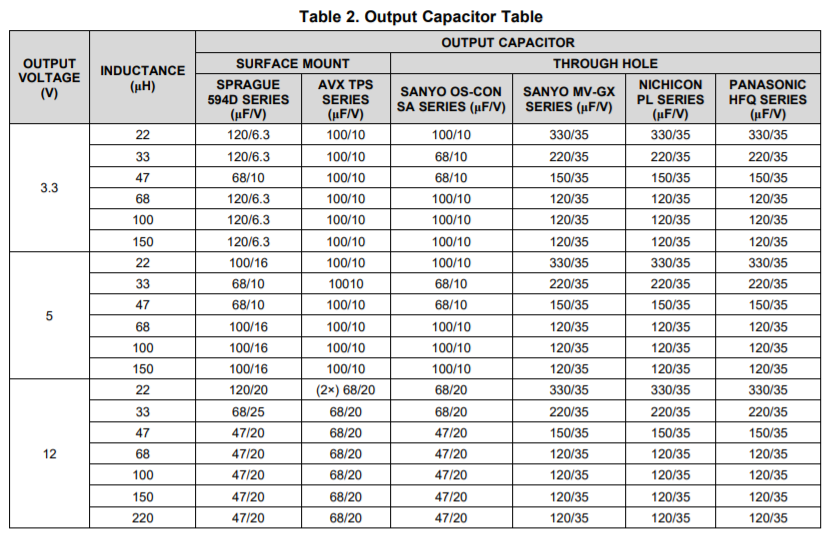

Can I use ceramic output capacitors with the LM2674 ?
In the Datasheet table 2 I find only electrolytic and tantalum capacitors.
What is the ESR-range to ensure loop stability ?

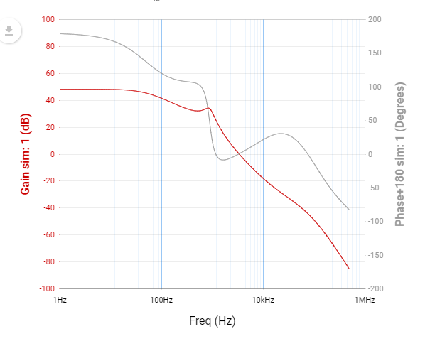

    I believe for this part, the ESR value is less relevant in order to ensure stability. I have attached a sample design on webench to simulate your design specifications
    https://webench.ti.com/appinfo/webench/scripts/SDP.cgi?ID=D1504BC56DCAA777
    The reason being is because internally we have 2 zeros to compensate for the voltage loop created by the regulator
    -Arief

    The 390uH suggested by Webench is not a recommended value in the Datasheet Table 2.
    I want to use 150uH and 47uH as reommended in Table 2 for a 24V => 12V/0.2A design.
    If I simulate with Webench with these values the Bode-Plot indicates a design that is not stable.
    Can you clarify ? Is there a bug in the Webench model ?
    What output capacitor should I use with an
    150uH inductor for a stable design ?
