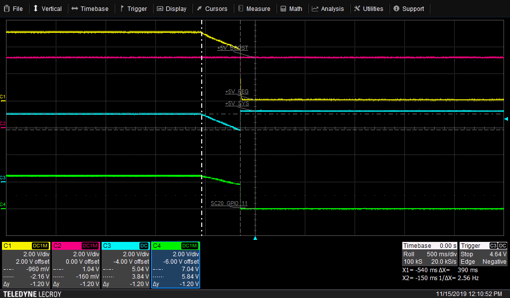

Case 1: No Load
When I unplug the main power supply, Output power (+5V_SYS) normally switch to IN2, but the switching time is 390ms. Is it normal?

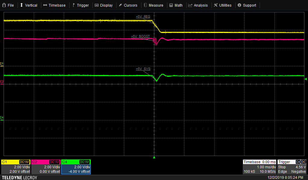

    After that, I was busy with my Backup System using TPS2121 (XCOMP mode) to prepare for our new design. Then, I was facing with another issue. Let me show you this malfunction.
    • Main Power: 5V/6A (Supplied from LM5116)
    • Backup Power: Supercap -> TPS61230 (for Backup Voltage is kept at 5V until voltage of Supercap reaches 2.4V)
    I test with 5V/1.5A Constant Current Load and this malfunction happens:
    • Channel 1 (Yellow): Main Power
    • Channel 2 (Pink): Backup Power
    • Channel 4 (Green): Output of TPS2121
    Zoom In:

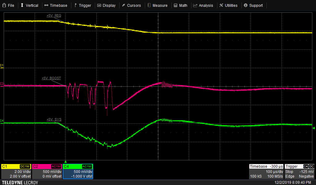

    There is ringing on Backup Power and the output of TPS2121 is unstable. These things make my system reset every time I unplug Main Power.

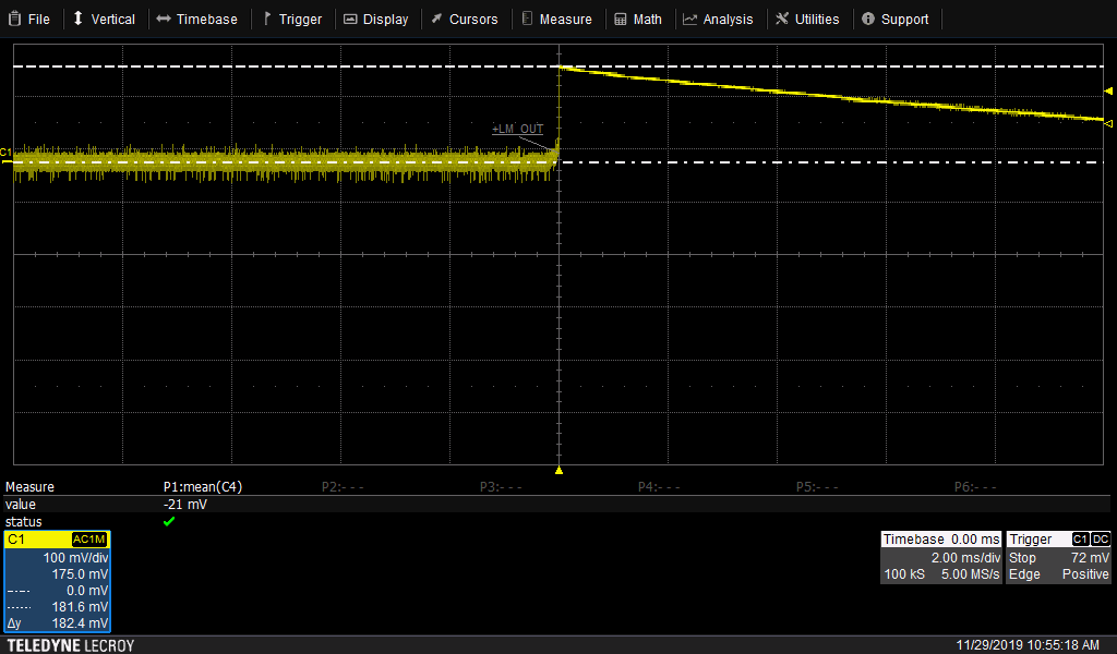

    As you mentioned about strong input, then I test the TPS61230 and see that it has bad Load Transient Response at 1.5A Load:
    TPS61230 - No Load to Heavy Load
    TPS61230 - Heavy Load to No Load
    As I use XCOMP Mode, output of TPS61230 will supply for CP2 through resistor divider circuit, so V_CP2 = 2.272V (TPS61230 - No Load). When Main Power falls down to approximately 4.5V (V_PR1 = 2.272V), TPS2121 switches to Backup Power, TPS61230 now changes from No Load to Full Load and a drop 450mV happens known as Load Transient Response. This time, I think TPS2121 does comparison again and fall into malfunction.
    I wonder if my explanation is the reason lead to this ringing phenomenon of XCOMP mode? If so, how can I solve the issue without changing any parts?

  • Hi Trong,
    Good to see that your design is moving forward.
    I think your understanding of the situation is correct. Because of the ringing on the second input, the output is being affected. This happens because of the sudden loading on the boost during a fast switchover.
    What is your total input capacitance on IN2? I think you may be able to add  more capacitance to smooth out the waveform.
    Please retry this fast switching in the XCOMP mode with the boost on IN2.
