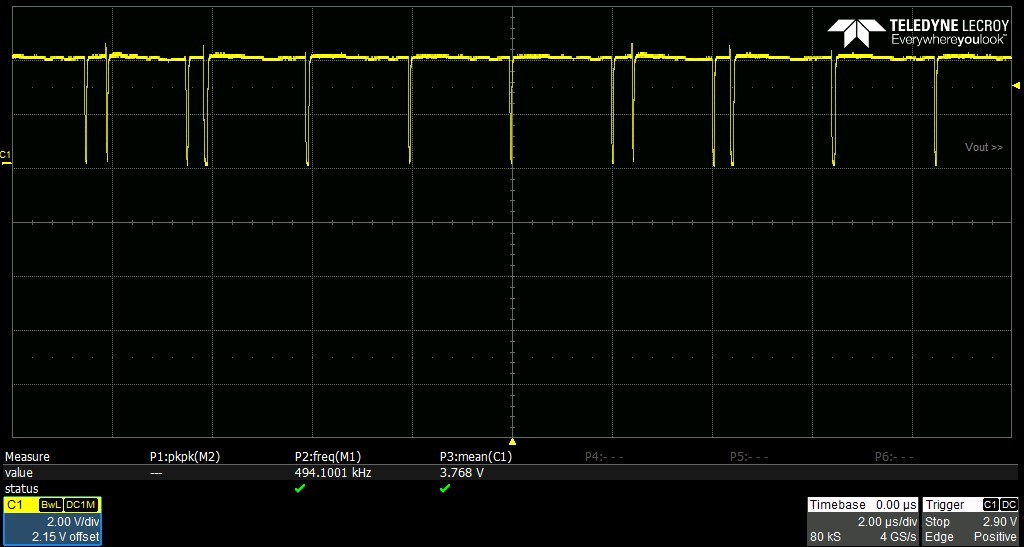

As above, I think oscillator frequecy should be fixed around 2.4MHz and duty may variate by LTE loading. I found one strange symtom that frequency may change to 820KHz sometimes when device runs under -20 degree C temperature. I don't know if it enters power saving mode. Is there any meachanism or cause that TPS63020 possibly operates at this ffrequency? When TPS63020 operates around 820KHz, the output voltage ripple also becomes a little bigger and also FB voltage is around 40mV bigger than normal frequency.

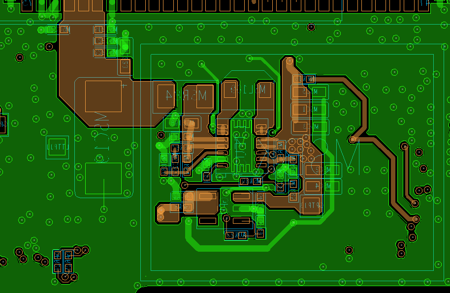

    2. PCB ayout

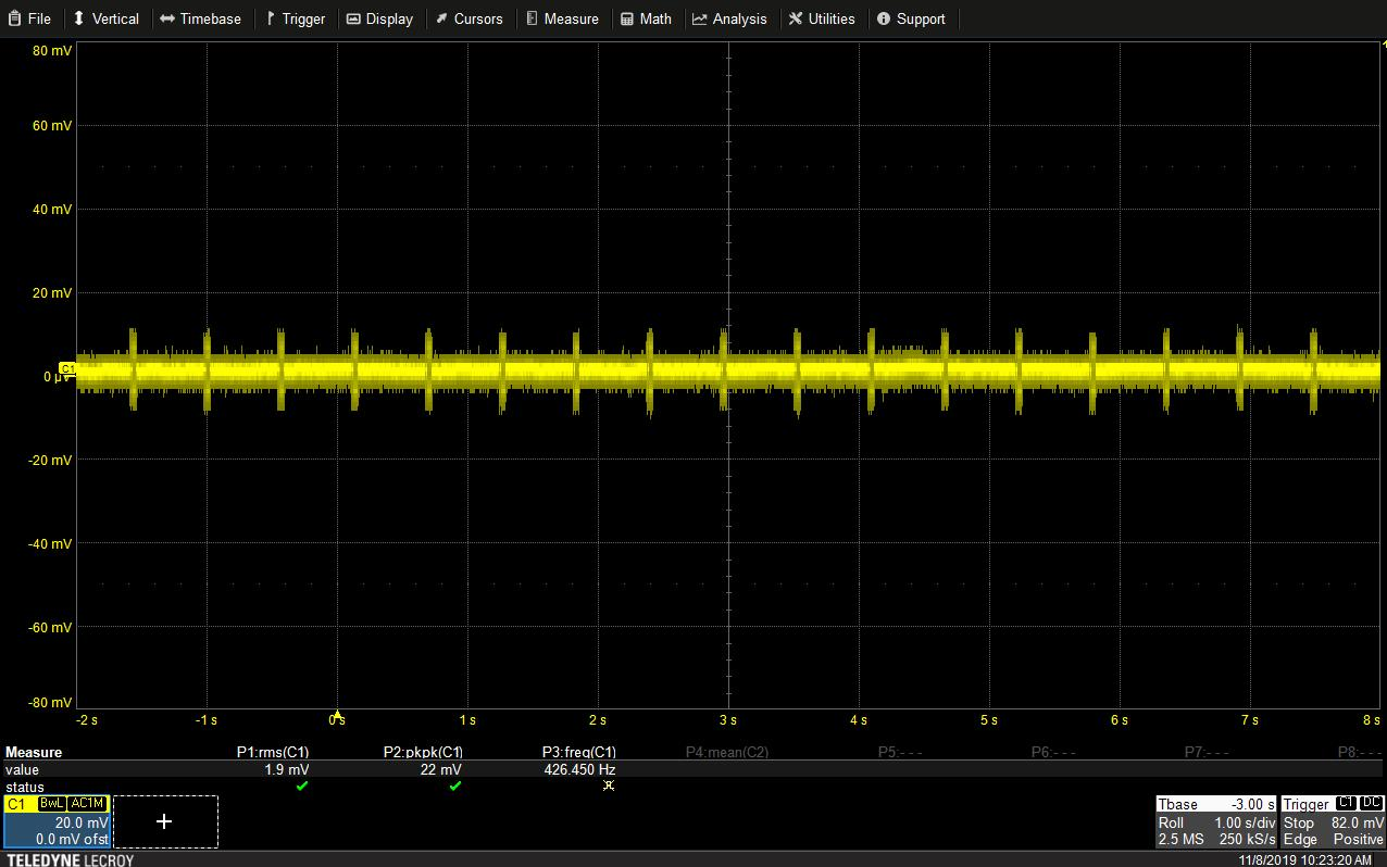

    3. Abnormal scope waveforms (f=828KHz)
    By the way, inductor and capacitor value may be decreased due to low temperature. I wonder if they are related and waht the IC internal works in theorem to cause frequencyvariation.

  • Hi Denny,
    If I see it correctly, there are only 1 µF and 0.1 µF ceramic capacitor on the output of the converter. The 330 µF capacitor is likely an electrolytic capacitor? As the minimum, we recommend 2x 22 µF ceramic capacitors.
    Can you please try adding more ceramic capacitors as close as possible to the output of the TPS63020?
    Milos

    1. Which signal did you show on the scope plot? Voltage on L1 pin maybe?
    2. When that signal was measured, what were the input and output voltages?
    Milos
  • Hi, Milos,
    Yes, it can be great improved by adding additional 47uF capacitor at output power.
    Regarding your questions:
    1. You are correct. I measured it at L1 pins of TPS63020.
    2. Input voltage is 5V and output voltage is 3.8V

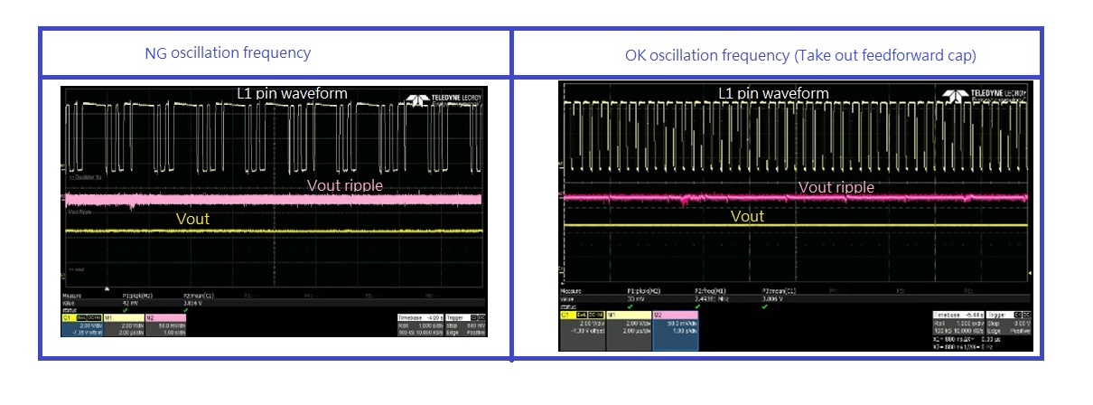

    - When issue happened, we still can see the abnormal waveform of oscillation frequency without system loading. We measured the FB pin ripple waveform as the following figure. We wonder if FB pin ripple cause this issue. Even we fixed IC in PWM mode, it is possible to cause frequency shift. If output capacitor is not enough, is it reasonable to cause this issue?

  • Hello Denny,
    1. Please measure L2 pin as well.
    2. Please measure the input and output voltage as close as possible to the IC. It is possible that the input voltage drops directly at the IC due to some effects in the system if you cool the system down.
    3. It is possible that your measurement shows GND noise instead of noise on the FB pin. It is very hard to distinguish the difference, especially when you need to get somewhat further away with the probes from the IC because of the low temperature setup. Hopefully the results of points 1 and 2 give us some more insight here.
  • Hi, Brigitte,
    Thank you for your reply.
    1. Please check the following figures for L2 pin waveform.
    - It is NG waveform when oscillator frequency is shift. L2 has pulse drop.
    - It is OK waveform when oscillator frequency is fixed. L2 is stable.

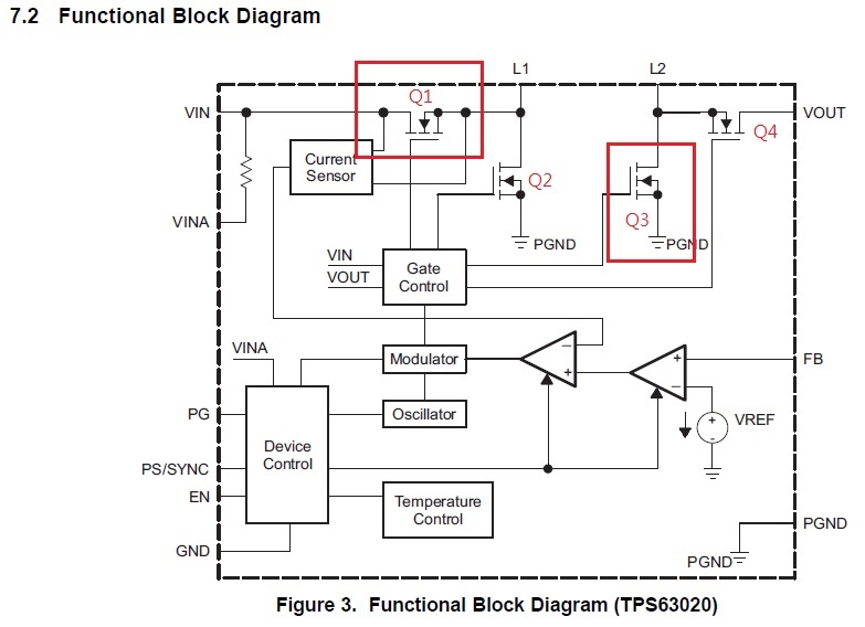

  • Hello Danny,
    You need to have a look on the inductor current or both switch nodes at the same time to measure the frequency. The waveform of 1 switch node is not enough.
    It seems that the IC needs to operate in buck-boost mode when you cool it down, to keep the output voltage.
    This could be for example caused by an increase in losses in the external components. Please observe the input current when you cool the system.

    We measured the device in the chamber with setting -20 degree C. We soaked the device 1 hour in the chamber then we took out the device outside, boot up the device and measured waveform and function.
    Today we measured L1 and L2 at the same time as the following figure. C1 in yellow is L1 pin and C2 in red is L2 pin.
    As you said, IC seems to operate in buck-boost mode. Q1 is for buck mode and Q3 is for boost mode in the following spec figure. Generally speaking, operation mode is judged by Vin and Vout voltage. If Vin >Vout, IC operates at buck mode. If Vin<Vout, IC operates at boost mode. I wonder if any other factor will cause operation mode control error.
    In the spec 7.1 it says "to avoid ground shift problems due to the high currents in the switches........" I wonder if it will cause the problem that I have.

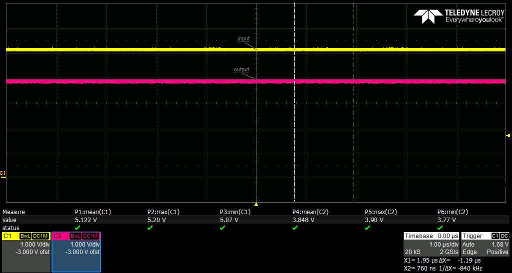

  • Hello Denny,
    Please measure the input and output voltage after cooling the device on MSC1 and MSC198.

    1. Input and output voltage after cooling the device on MSC1 and MSC198.
    C1 in yellow is input voltage;
    C2 in red is output voltage;

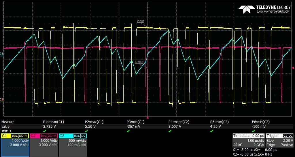

    2. L1 pin, L2 pin and input current in abnormal symptom.
    C1 in yellow is L1 pin waveform;
    C2 in red is L2 waveform;
    C3 in blue is input current waveform.

     More information for your reference. There is compensation circuit in FB design. We tried to remove compensation circuit and it also improved.

  • Hello, Brigitte,
    I test over 100 pieces of boards. 90% of the boards have this issue under low temperature. We also designed compensation circuit with same value as application circuit.
    After I removed C4 4.7pF, the oscillation frequency became stable and kept about 2.4MHz. I am also trying to figure out if PGND soldering status or PCB layout  will cause this issue or not and relationship in theorem.

  • Hi Denny,
    Could please tell me where exactly on your PCB you measure the current in your posted picture.
    Here is a scopeplot for your reference , which I measured @25degC.
    Moritz
  • Hello, Moritz,
    I measured inductor current at L1 pin (separate pad and inductor).
    Thank you,

  • Hi Denny,
    ok, i thought this was your input current, but that makes more sense.
    Can you please restate which problem you are having? Do I understand correctly, that you have improved the regulation by taking out the feedforward cap in the feedback resistor network?
    Moritz
  • Hello, Moritz,
    Yes, your understanding is correct. After I removed cap in the feedback resistor network, the oscillation frequency became normal as the following figure.
