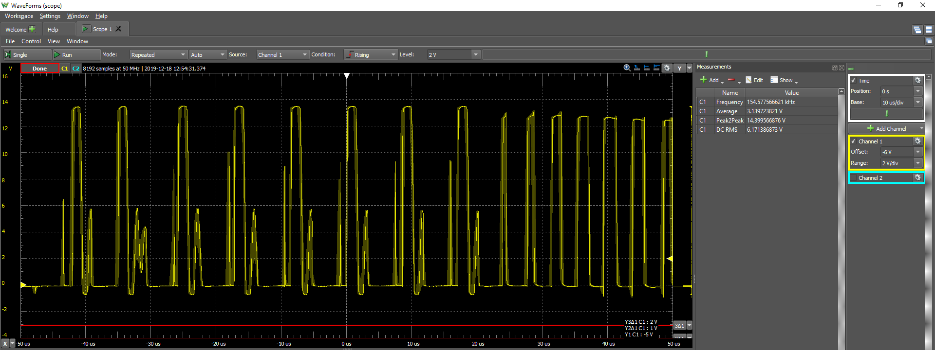

I have created a variant of the evm board from files previously provided in this forum, effectively so I can use it for a custom battery charging solution. First off, I own one of the EVM boards and can confirm it works very well. I have been trying to do both schematic and electrical comparisons between the EVM board when its in operation against the one I have designed.
Powering mine up I noticed that its default power usage is ~85mA@12V against the 15mA@12V on the evm board. My board is outputting at 0V at Vout. A few obervational notes:
- The input series 10Ω resistor to Vin is dropping ~800mV
- HDRV1 is showing as a noisy ground signal. Even after disconnecting all components on its net, its still sits at 0. See scope below.
- I have 2 boards built up that have the same current draw/results/issues
- When i pull the enable pin to ground, my board draws 0mA, so it appears that current is not leaking outside of the IC
- I have reflowed majority of the components at least once and tested everywhere possible for shorts
I created the following table of observations:

HDRV1 output signal: scoped

  • Hi Ryan,
    Thanks for reaching out with your question and for using the LM5176.
    Can you please re-check the voltage on the RT pin (pin 6)? Did you use the same layout as the EVM? Taking a look at the schematic I don't see anything that sticks out as being incorrect.
    Have you checked with a different IC?
    Garrett

    This is the typical waveform I get for quite a few of the IOs, the ramp up and sharp drop off. This is pin 15, CSG.
    At least at this point I can now see switching of my driver circuits. Below is pin 25 (LDRV1) then pin 27 (HDRV1)
  • Hi Ryan,
    Pin 15 (CSG) should not be going to 8V, in normal operation it should be very close to ground. It looks like there might be something wrong with your board.
    Do you have multiple boards? Are you seeing similar issues on other boards?
    Garrett

    When laying out the pcb in altium, I based it originally on the the design files of the eval board and replaced the components one at a time to match the components that we would typically use in the office. I am happy to send the design files on if you could provide me an email address that could make it easier to look through as well. This is what the laid out PCB looks like atm. Please note C48 is replaced by a 0R to match the eval board settings I have been working with. Also note that the eval board uses a 0R in place of R28, so I have tried to match its values. C1 component link: https://www.digikey.com.au/products/en?keywords=493-1668-ND
    I feed power in through the Green and Red cables, and draw a load on the white ones. Specifically when I mentioned that the input bulk capacitor was causing me an issue, you can see in the schematic R28. I have disconnected the resistor and replaced it with a short circuit, a bar. When I take the bar off, the power supply powers up into regulation (when placed in boost mode as mentioned in previous post). Though when it is reconnected, the power supply fails to go into regulation and starts constantly switching on and off, shorting my bench-top supply. The benchtop supply in these examples is set to a limit of 12V @ 350mA.
    The additional circuitry on the side is not placed at all and is used to measure and control the voltage and flow of power in a battery charger styled solution.
    Following on from your other query, below is the scope measurements of SW1 and SW2. First off the 2 images below is when it is regulating correctly, input bulk capacitor is open circuit through R28. I figured that while the input capacitor is charging, it holds the input supply down for a few uSeconds or so, then the PSU starts to try and regulate in boost mode and gets stuck in this mode. On the other hand, if the capacitor is removed, the transient response is much quicker, so the PSU won't start in boost mode, but buck instead.
    SW1 above regulating well with 12V input, 10V output.
    SW2 above regulating well. with an input of 12V and output of 10V.
    On the other hand, after it has been regulating well and I drop the input voltage to 11V, the PSU goes out of regulation.
    SW1 above, 10us timescale, out of regulation. 11V input, 10V target output
    SW1 above, 4.62ms tmescale, out of regulation. 11V input, 10V target output
    SW2 Above. 4.62ms timescale, out of regulation. 11V input, 10V target output
