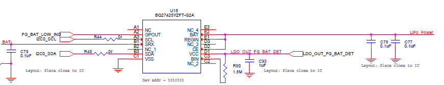

I have a new design with BQ27425-G2A  and 3.7V lipo battery.
When I measure the resistance between SRX and VSS I get ~200Kohm, as opposed to the expected resistance value noted in the datasheet
Once I connect the battery I get around 0.9V voltage difference between SRX and VSS.
It is worth mentioning that have the same problem in two differnet boards.
