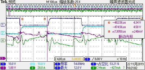

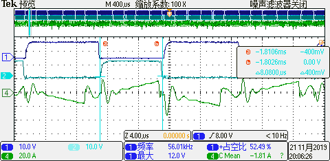

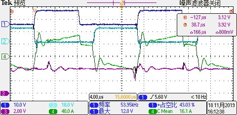

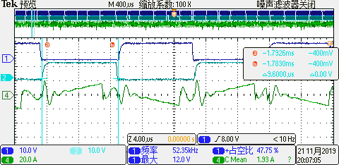

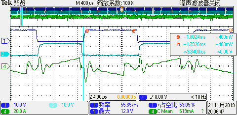

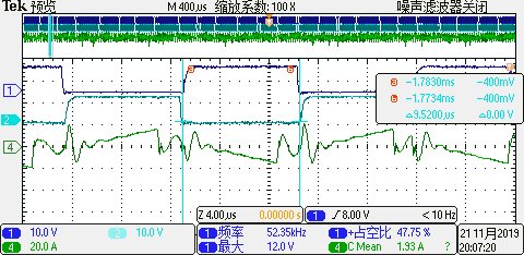

Thanks for your reply.
The first two pictures are normal situation. The Ton and Toff are alomost equal. The dead time is 300ns. (CH1-OUTA, CH2-OUTB)
But the following two pictures are abnormal ones. The Ton of CH2 is 8.08us, the Toff of CH2 is 9.84us. The difference is too large. Also, the CH1's Ton>Toff. (CH1-OUTA, CH2-OUTB)

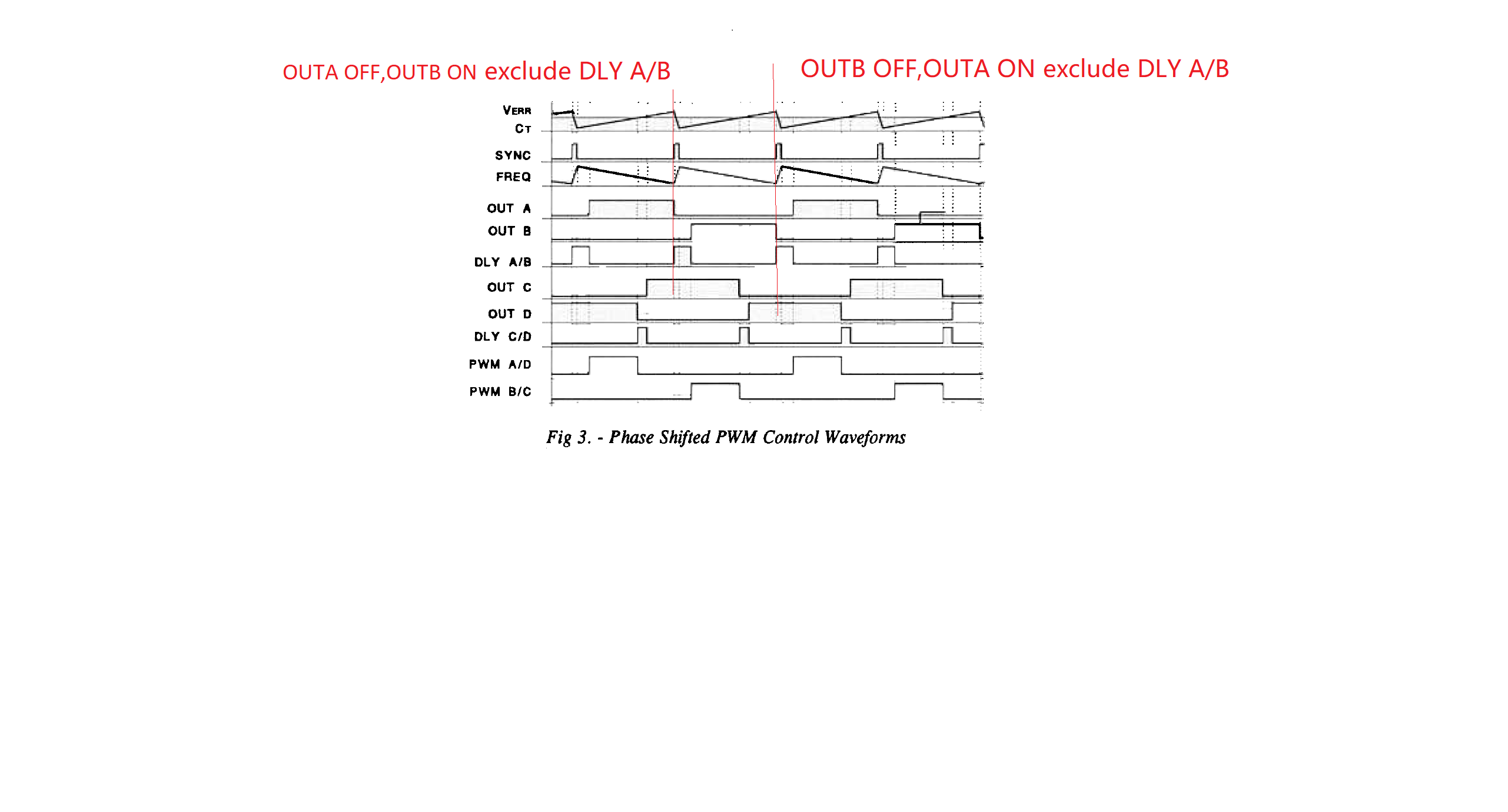

Dear user,
since there is no timing diagram in the UC3875 datasheet, I copy from other phase shift controller as attachment for you reference. according to the timing diagram, I you can get the information what is the decision conditions of the OUTA/B ON or OFF. the key is the SYNC and Freq waveform. so, can you please double check the waveform on the PIN SYNC(17) and Preqset(16) compare with the OUTA/B. you can show the waveform here if you are available.
If you find there is noise on these PIN, you have to find the noise source and fix it.
let me know your status.
thanks

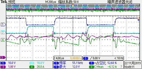

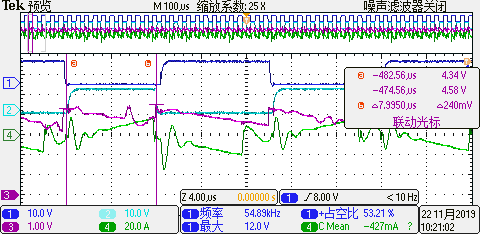

I have captured the pin(fset) as the following picture. CH1-OUTA, CH2-OUTB, CH3-fset. The waveform did have some noise that affected the timing diagram.
The following picture is the sync pin---CH3. It did have noise on this pin. But I don't know if it affect the timing diagram. In some place, the voltage of SYNC exceed the high voltage but the OUT is still high.
I don't know how to improve the chip anti-interference.
Dear user,
It seem that the signal of FREQ is disturbed.
It is difficult that fix the noise issue through theoretical analysis. So, you have to try variety of way to solve this issue by yourself.
