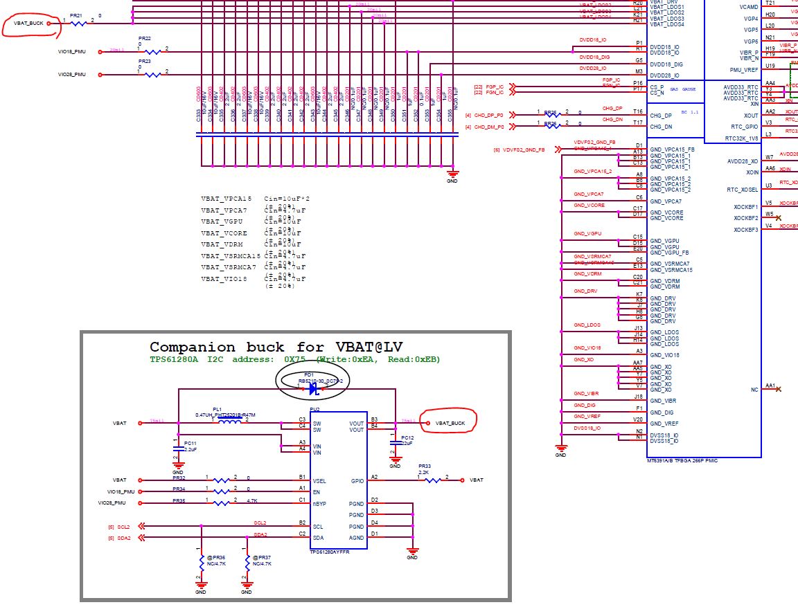

We found the product got the leakage issue around 13mA. The processor FAE told us that is known issue. Do you have the document to explain it? How to fix the issue in current PCB? Does the D version will fix it? Thanks!

    1.The SOC platform is MediaTek MT8176 ( PMU is MT6391A), and TPS61280A is the battery frond-end converter. There is a Schottky Diodes between Vin and Vout of TPS61280A for MT6391A.
    2. When system is OFF and the user short pressed power button, the TPS61280A is ON/OFF in a very short period. After the procedure, the TPS61280A  will have 13mA leakage current.
  • Hi Amos,
    are you from MTK or the end customer using this device? the behavior is related to the internal behavior of this device and the external diode, and also the EN/nBYP logic. the device could enter shutdown mode during the period that EN nBYP decreases. the device will exit shutdown without external diode. however, with the diode, the device can't exit the shutdown and consume 13mA.
