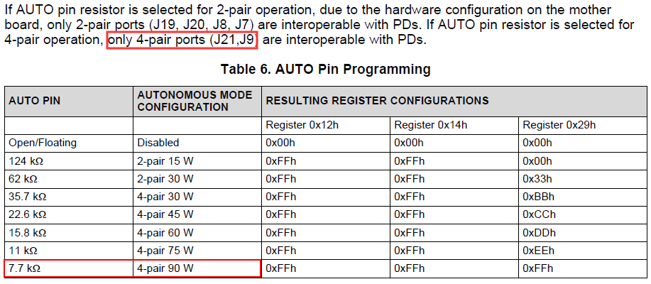

    " SLVUBP0A TPS23881EVM: PoE, PSE, TPS23881 Evaluation Module " also said that " The TPS23881 device must be configured through the host to become operational. This EVM provides two ways to control the TPS23881: TPS238x EVM GUI (with USB2ANY) and MSP-EXP430FR5969 LaunchPad. "
    Is this a mistake ?
  • User6233052,
    If the auto pin resistor is configured properly on the TPS23881 or TPS23882, no software configuration is required for power up.  Please refer to section 4 on page 8 of the EVM User Guide for additional information.

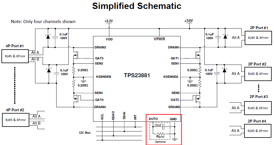

  • 1,  As showed in TPS23861 Datasheet Simplified Schematic, AUTO pin can be floating, R_AUTO resistor is Optional.
    But PIN Description section said that " Floating AUTO pin will disable autonomous operation. "
    Is this a conflict ?
    2,  If I want a true AUTO mode of PSE TPS23881 in our application system for PD whose power is from 30W to 90W or above, than the AUTO pin must be connected a 7.7k ohm resistor to GND ?
    3,  If I select the 7.7k ohm pulldown resistor on AUTO pin of TPS23881EVM, ports J21 and J9 of the PSE (TPS23881EVM and BOOST-PSEMTHR-007) can deliver 90W power separately which sum is 180W or simultaneously which sum is 90W?

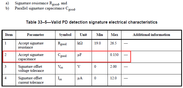

    4,  What the “ Channel capacitance measurement range ”(in TPS23881 Datasheet) stands for ?
    It refers to the “signature capacitance ” in IEEE Std 802.3 ?

    1. If you leave auto pin floating, the autonomous mode is disabled. You will need configure the device through I2C.
    2. If you configure auto pin to 90W, all ports will have the same configuration. One TPS23881 is configured as four 90W ports. The max power of each port is 90W. It can’t go above 90W. If you need higher power limit, you can’t use autonomous mode. You will need leave auto pin floating and configure it to semi auto mode.
    3. 90W is at port level. If you want to control total ports’ power, you will need a host to do power management.
    4. The cap measurement range of TPS23881 is to detect nonstandard legacy devices which usually present high capacitance on the port. It does nothing to do with the standard.
