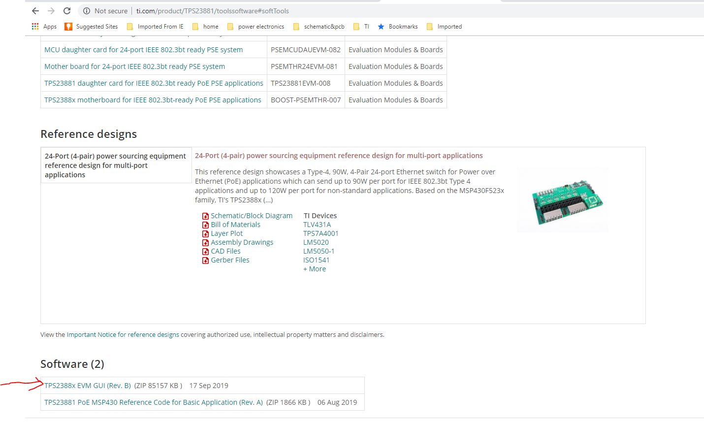

Can you connect the board to TPS2388xEVM GUI and see what kind of fault you get when you have these kinds of failures? Thanks.
Penny
Hi Caspar,
I was referring to the GUI here:http://www.ti.com/product/TPS23881/toolssoftware#softTools. I will try if I can reproduce this issue on my board this week and get back to you. Thanks,
Penny

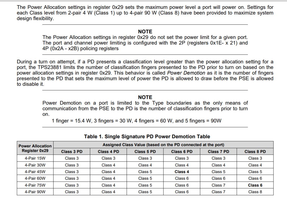

Hi Caspar,
When you have issues with 45W and 75W, what's the class level of the PD?
When you set the PSE to 45W and the PD is set to above class 5,the PSE should demote the power to 30W.
Similarly, when you set the PSE to 75W and the PD is set to above class 7, the PSE should demote the power to 60W.
Penny

Hi Caspar,
You test results are expected.
Please me explain the reason one by one.
1.PSE set 45W/PD set class 5=>output about above 40W
[Penny]The PD's DCDC has 90% efficiency. Considering cable losses and PSE's 2.5% PCUT accuracy, ~40W is a reasonable number.
2.PSE set 45W/PD set class 6=>output about under 30W
[Penny]This is expected due to power demotion
3.PSE set 45W/PD set class 7=>output about under 30W
4.PSE set 45W/PD set class 8=>output about under 30W
[Penny]These 2 are also expected. The "class 5" in your highlighted box is a typo. These should be class 4. We are working with documentation team to fix this. Sorry for the confusion.
Penny

Dear Penny:
Sorry!~I'm not understand about this table.
could you example use PSE class 5 setting?.
And simple description how to look for this table.
Thanks!
Caspar
Hi Caspar,
Basically, PD assumes PSE is able to send 15W for 1 finger (Type 1 or Type 3), 30W for or 2 finger(Type 2) or 3 finger(Type 3), 60W for 4 finger (Type 3) and 90W for 5 finger(Type 4). If PSE is only able to send 45W, there's no way for PSE to tell PD it can only send 45W instead of 60W. So PSE can only demote to 3 finger 30W to prevent PD drawing more than 45W. Please review this white paper(page 22 to 23) for more details. Thanks.
Penny
