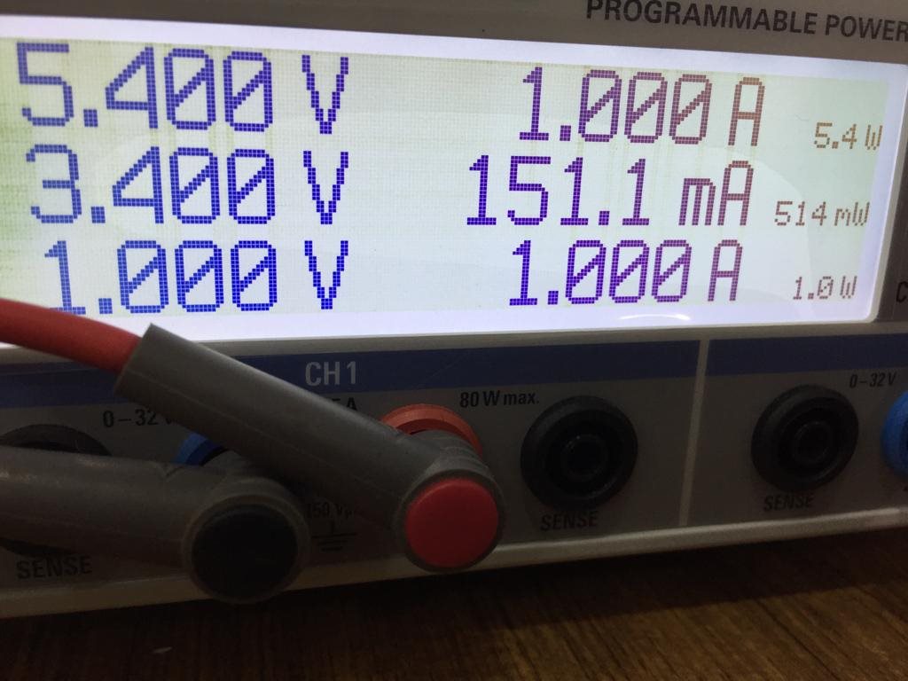

I used the smartphone as a load and saw that I draw a current of 151mA. My phone didn't charge when I took 151mA.

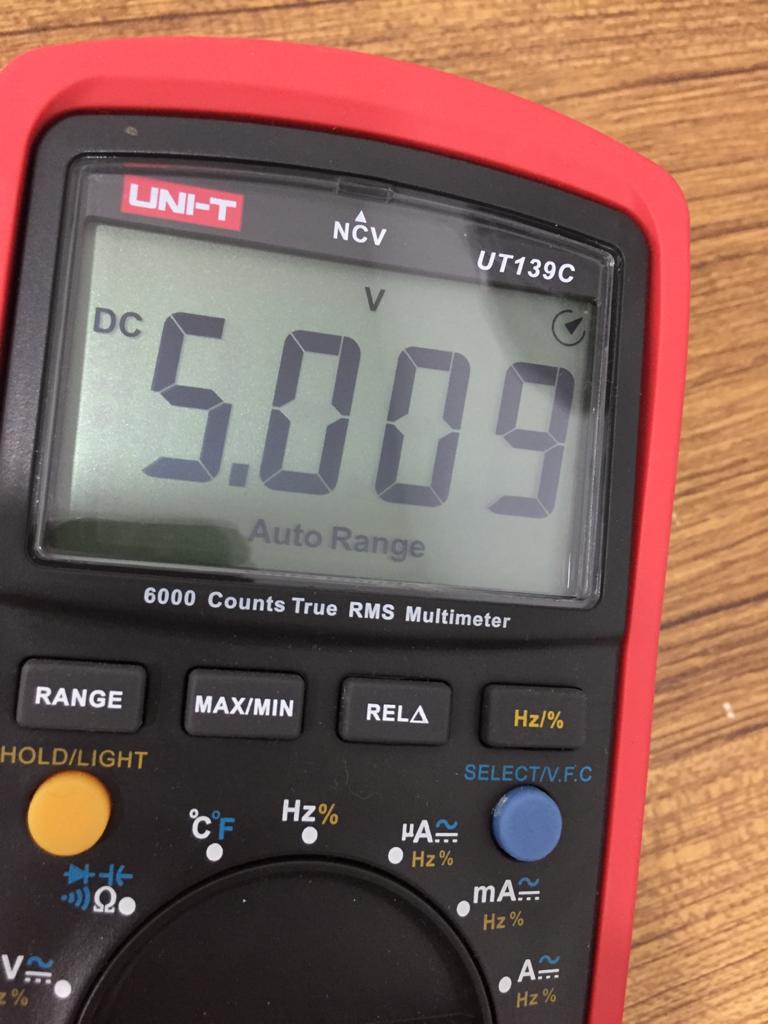

Now I have 2 questions (I can see my output voltage is constant 5V):

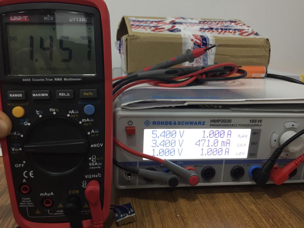

    To find out if there is a problem with the phone, I've tried something like this:
    -3.4V from the power supply to the booster input, 2.2 ohm resistor as a load connected to the output.
    I measured the output voltage of the booster to 1.45V and measured at 440mA over 2.2 ohms.
    Normally, I think, I should see 5V / 2.2Ohm = 2.27A over 2.2 ohms.
    How can we solve? I had a mistake in layout when designing another converter before, could it be the problem here?
    Waiting for your support..
    Mehmet
  • Hi Mehmet,
    please remove the 2.2ohm firstly. after the device finish startup, then connect the loading again.
    this device has short circuit protection, which limit the output current when VOUT is lower than VIN.

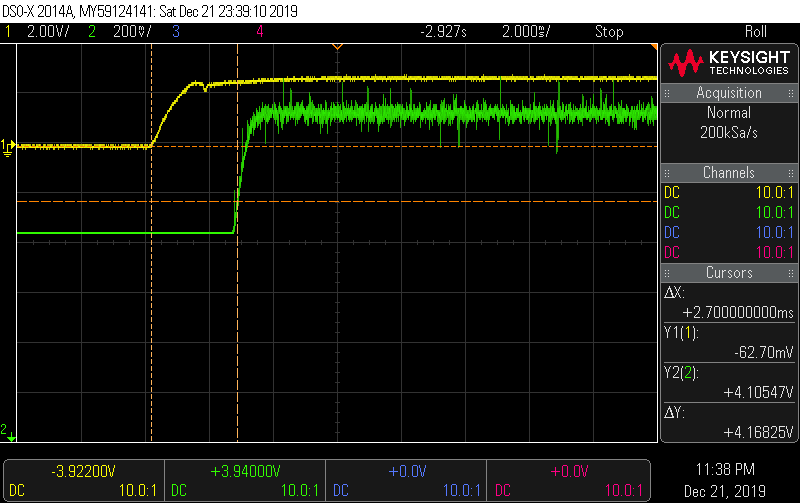

  • Hi Jasper,
    Although I was doing the same thing I did before, I got different results.
    I captured on how Vin and Vout waveform behave when I put 2.2ohm into the circuit as you wanted.
    Figure 1
    Figure 1 is the behavior at the time I put it first.
    Figure 2 :
    Also the input current was not limited to 1A but always 3A.
    Although I give 3.4V from the input, you can see that I am falling down to 2.7V and the output is not 5V but 4.42V. In this case, I draw about 2A from the source.
    The input and output voltage continues to decrease as the current drawn from the source increases.

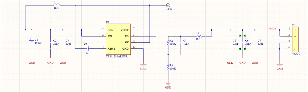

    I also share the schematic.
    please also layout image and also the inductor part number.
