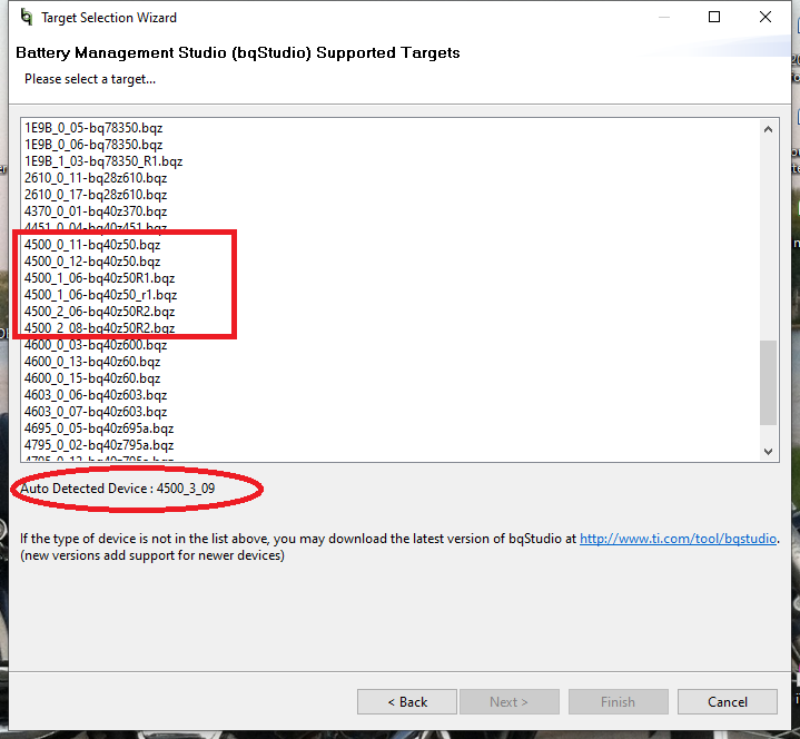

I have Down loaded the new and the latest test files for BQstudio.   It appears that maybe the nw file SLUC525V which gets downloaded is not really the latest (V 1.3.96) .  Version R3 does not show up in the program or in the CONFIG directory.

    We started releasing bqzs as part of the FW release on the products page.
    Go to the bq40z50-R3 products page and download the FW package. You will find the bqz file there. Place it in the config folder in the bqStudio directory.
